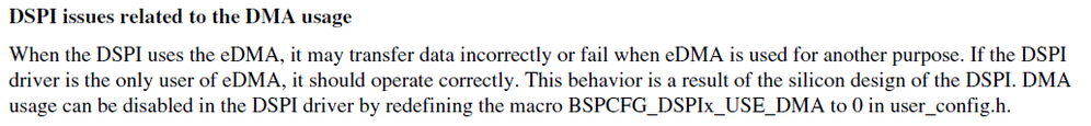

Hi Paul:
Please refer to known issues and limitations of the DSPI issues related to the DMA usage in MQX_Release_Notes.pdf

Thank you for your reply. I knew this issue, so I was using eDMA for SPI2 only, SPI0 and SPI1 are using normal interrupt based. Before DMA implementation, I was using SPI2 as interrupted based but which made some context switching delay between task. how can I used current eDMA I/O peripheral driver in interrupt mode?
