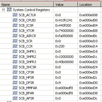

I've been stuck on this for almost two weeks, and I've made little baby steps of progress, but I'm still getting nowhere. :smileyangry:
So far I've determined that I do not get past the "SVC" instruction in _sched_start_internal(). This is the first SVC call in the loaded application. As soon as I try to step over that instruction, the system crashes and restarts.
I've been able to determine that the reason for the crash is a core lockup (RCM_SRS0 is 0x00, and RCM_SRS1 is 0x02) I've also updated the vector table with custom handlers that pulse various I/O pins to let me know if they ever get reached - none of them ever do, it certainly looks like it never gets past the SVC instruction.
Trying to figure out why this is happening, I found this thread:Tracking Down Hard Faults -- https://community.freescale.com/thread/306244
The first reason stated in there is "execution of an SCV instruction at a priority equal or higher than SVCall." This sounded very promising, as it sounds like what's happening to me. But I'm not seeing it. The SVCall priority is 0x10. The SCB_ICSR register shows that no interrupt is active, therefore I'm at Thread priority. So there doesn't seem to be a priority issue here. Dang, I was hoping I was on to something.
At the time that I'm about to step on the SVC instruction, these are the values of the SCB registers:
It's interesting to note that I am now getting exactly the same values whether I run my application stand-alone in DDR through the debugger, or if the bootloader loads it from SD card into DDR memory. I don't know what changed from before where the SCB_ICSR register was 0x00400000 when running stand-alone throug the debugger. But at this point, it's behaving exactly as it does under the bootloader, except that it doesn't crash!
From looking at these, it appears I'm in Thread mode, so not currently executing any exception. According to SCB_ICSR I'm on Thread mode not currently executing an ISR, and I've got a SysTick interrupt pending (priority 0x40 as per SCB_SHPR3.) So it looks like I should be able to process either the pending SysTick interrupt, or the SVC call. But I can't.
Are there other registers I should be looking at that might explain why the SVC instruction fails?
Anybody got any ideas? I'm at my wits end...

bjoernjohanness
Adam,
first of all I didn't get anywhere really with configuring the DDR. I just stuck with the "deaults" from the Tower setup. I'm upset with Freescale not documenting the registers fully so I gave up since their support keeps disappointing me.
I read your two posts and I feel like you're sooo close. The first thing that came to mind is that there are two different stack pointers, one for thread mode and one for supervisor mode. Unless you setup the supervisor it would (most likely) crash at the first Supervisor Mode instruction which is what you're describing. Please make sure you setup the Supervisor SP prior to entering SVC.
Also, the most useful thing when working on things like these (to me) is using a "non-supported-exception handler". Any exception that you don't supply a handler for would execute this handler. I use this to print out all the registers that will let me decipher what went wrong, including the current last ~128 bytes of stack.
BTW, running from ram is very slow compared to internal memory unless you enable cache. At least on my setup.

avm
Bjoern,
Thanks for the reply! Yes, I feel like I'm so close, just not quite there. It's been very frustrating.
You really got me thinking about the two stack pointers. I believe they are both valid, but there might be something there. However, as I look at the register contents from running under both conditions (debugger which works, and bootloader which crashes) both stack pointers appear to be valid, and both have the same contents under both conditions. But I will continue to investigate this idea. One thing I didn't do was to look what was on each stack in the two cases to see if there are any differences.
I've done a basic unexpected interrupt handler in the past, and it has indeed been helpful. In this test application for RAM, I went so far as to put in a dedicated exception handler for every fault and ISR -- none of them get called: It seems to go straight from the SVC instruction to the reset condition with no intermediate stops. That's what has me so intrigued about your stack pointer comments - if there was a stacking issue, I suppose that could prevent the processor from entering the exception handler, and I suppose the end result could be a core lockup that I'm seeing? I'm relatively new to the ARM architecture, so I don't know, but it sounds like a plausible enough theory to pursue it a bit.
As for timing, I obviously haven't gotten far enough to do any timing tests. Fortunately, I think I can get away with slower execution for my application. My code does a lot, but it doesn't have to do it very fast. Rather than churning a lot of high speed data, it's doing mostly low speed control with some long and complicated state machine sequences -- lots of code, but not a lot of data throughput. It's more of a machine controller rather than a data analysis engine.  Even running out of slow RAM, I think the K70 will have plenty of processor headroom. Time will tell.
