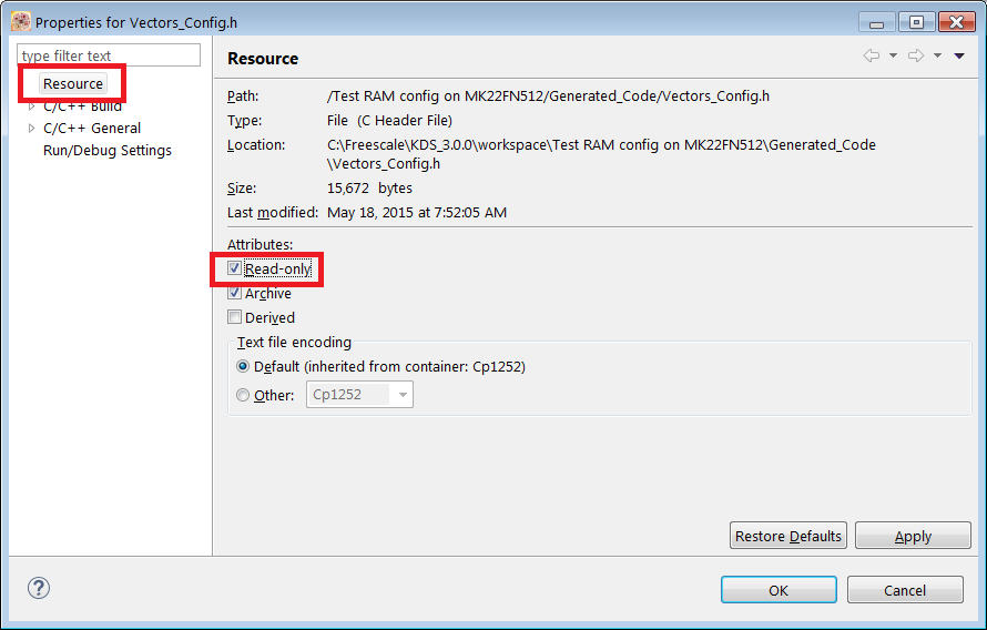

Since I am using the stand-alone PEx, the files Vectors.c and Vectors_config.h.get written over each time I "Generate Processor Expert Code" and I lose my edits. Is there a better way to modify the vector table than editing Vectors_config.h. after each PEx compile?

marek_neuzil
Hello Mark,
There is one workaround to avoid changes of a generated file by Processor Expert. When you set the read-only attribute of the file that you have modified manually, the file is not modified by Processor Expert. There is reported a warning during generation of code by Processor Expert (for example:
Generator: Warning: Error during writing to file: C:\Freescale\KDS_3.0.0\workspace\Test RAM config on MK22FN512\Generated_Code\Vectors_Config.h) that can be ignored.
You can set the read-only attribute in the Properties of the file (in the Project Explorer window click on the file by right button of the mouse and select Properties).
