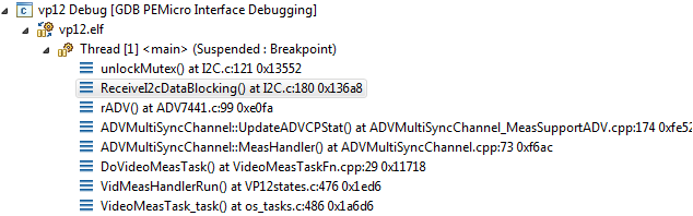

In Kinetis Design Studio, I've been using MQX with multiple tasks. The Task Aware Debugger has been a very useful tool when debugging, but I am curious if it is possible to see the current program stack for all the tasks whenever I pause the debugger?
This is what I'm referring to below. I am only able to see one task's program stack.

This has come up before, e.g.: How to view call stack which task is not actived in KDS
There isn't a solution. The answer appears to be that you can only see the stack for the currently active task. It seems KDS is not really ready for serious usage in this regard.

RadekS
Thank you for your note.
The true is that you get it for what you paid for.
KDS is built on open source components and therefore it is offered for free.
You can anytime create/modify your implementation of GDB server and add support for this feature.
I just discover that one of our engineers already made some modifications in OpenOCD  debugger, but this change is still not released.
For more details, you can look at: http://openocd.zylin.com/#/c/2599/
So, if you have time for debugging debugger, you could apply this patch to OpenOCD and try it.
I hope it helps you.

Radek, do you know if there is a way to get the program counter of a currently inactive task when debugging? Or if there is perhaps an API function call that could return this information? If I was able to simply retrieve the program counter of another task, I could find what part of code it has stopped at easily. It would help out a lot when debugging.

I have previously modified MQX/mqx/source/tad/tad.c so that the shell "tad stack" command includes the PC in its output. This might help you.
-- 336/tad.c Wed Mar 18 13:16:29 2015
+++ 337/tad.c Wed Mar 18 13:16:16 2015
@@ -323,7 +323,7 @@
    char_ptr                 task_name;
    printf ("\nStack Usage:\n");
-   printf ("Task   Stack Base   Stack Limit   Stack Used   %% Used   Overflow?\n");
+   printf ("Task   PC   Stack Base   Stack Limit   Stack Used   %% Used   Overflow?\n");
    size = _QUEUE_GET_SIZE(&kernel_data_ptr->TD_LIST);
@@ -352,7 +352,7 @@
          percent = ((_mqx_uint_ptr)td_ptr->STACK_BASE - stack_used) * 100 / ((_mqx_uint_ptr)td_ptr->STACK_BASE - (_mqx_uint_ptr)td_ptr->STACK_LIMIT);
-      printf ("%s   0x%lx   0x%lx   0x%lx   %ld %%   %s\n", task_name, td_ptr->STACK_BASE, td_ptr->STACK_LIMIT, stack_used, percent,percent>=100?"Yes":"No");
+      printf ("%s   0x%lx   0x%lx   0x%lx   0x%lx   %ld %%   %s\n", task_name, *(uint_32*)(td_ptr->STACK_PTR + 64)-1, td_ptr->STACK_BASE, td_ptr->STACK_LIMIT, stack_used, percent,percent>=100?"Yes":"No");
       size--;
       td_ptr = (TD_STRUCT_PTR)((uchar_ptr)(td_ptr->TD_LIST_INFO.NEXT) - FIELD_OFFSET(TD_STRUCT,TD_LIST_INFO));
That patch applies to MQX 4.0.1 rather than the latest, but it looks like the source hasn't changed much since then.

DavidS
Hi Matt,
Attached is an example I did using MQX back in 2011 to find PC of a task descriptor.  I started with the mqx/examples/lwevent project.
Hope it helps.
David

RadekS
Unfortunately we are not able manage it by TAD.
This information (current program stack for all the tasks) could be obtained only by debugger who deeply know elf file and who know how data are stored on stack.
Theoretically we can read it from task stacks, however structure of information in stack is inconsistent and we do not know any fix point where we can read PC value.
Information about current program stack for all the tasks is one of CodeWarrior debugger features, however it seems that open source debuggers doesn’t offer such feature. Maybe I am wrong and there is any option, but unfortunately I do not know about it. I am sorry.
