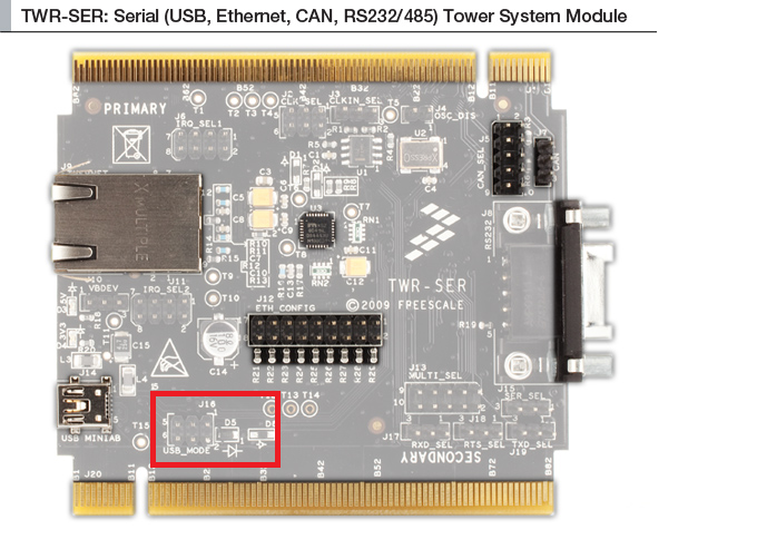

steeevo
I don't have any jumped on J16. It has smaller closer pins and on't look like standard jumpers.
Are we talking about the same thing here?
1,879 Views
soledad
J16 is for TWR-SER. In order to use the http server example you need to connect the TWR-SER or TWR-SER2 to the TWR-K60D100M.
Please check the below image.
In addition, you only need to double check the below jumper configuration:
o TWR-K60D100M - Jumper J10 on position 2-3 - processor clock taken from the TWR-SER board
o TWR-SER - CLK_SEL 3-4
o TWR-SER - CLKIN-SEL 2-3 (processor clock is taken from PHY)
o TWR-SER - ETH-CONFIG J12 9-10 to select RMII communication mode
