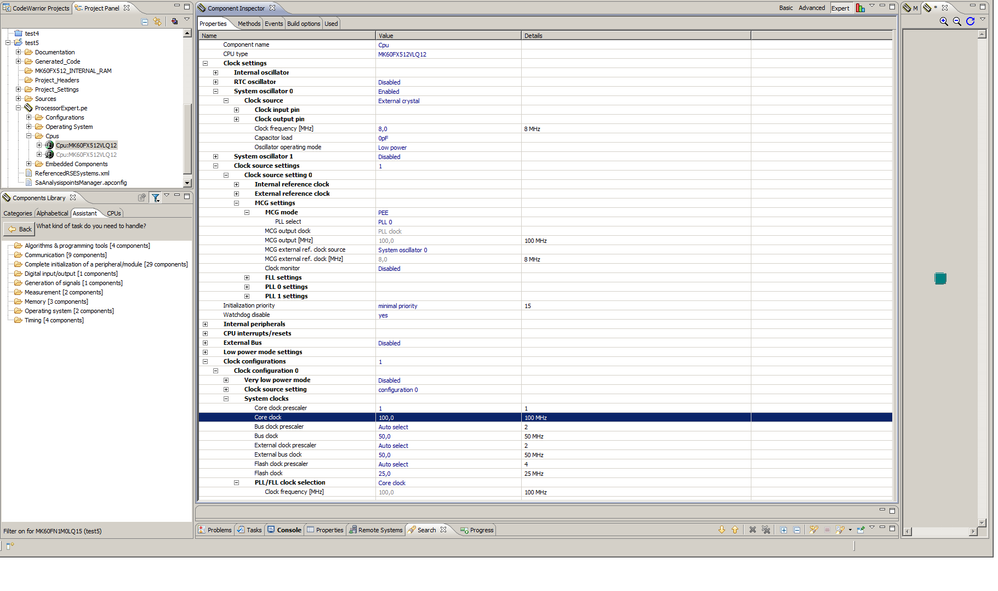

I created a test project with CW 10.2 and selected PE-support.
The configuration is shown in picture below and register initialization is in attached C-file.
~Mark

MarkP_
Contributor V
I think 50MHz cannot be generated from 120MHz CPU clock, need to be 100MHz.
