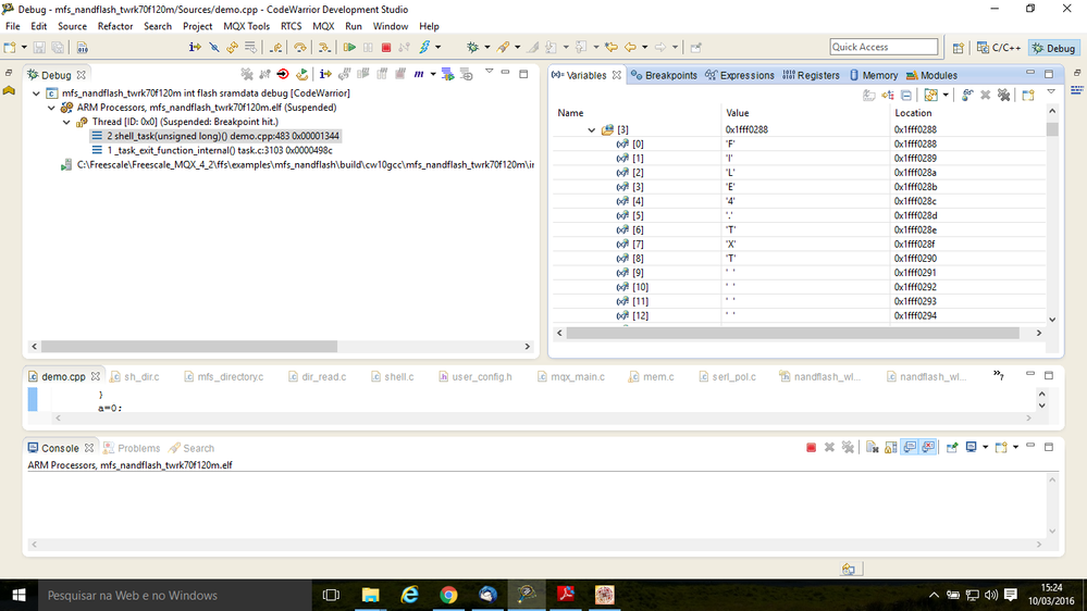

After long hours of struggling, I have finally found the correct functions to do what I need. After installing the apropriate drivers and a file system, I just called "_io_get_first_valid_fs" to get a valid file system pointer, alloc a memory space for the buffer which receives the files names, open the directory, check if the file system pointer is valid, read the directory content and save the files names into vectors. Then, I close the directory.
I made a smal test in mfs_nandflash_twrk70f120m demo project: I added some code to "shell_task" and I would like to share it. Maybe somebody may find it useful:

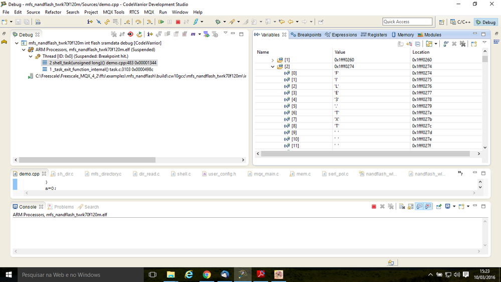

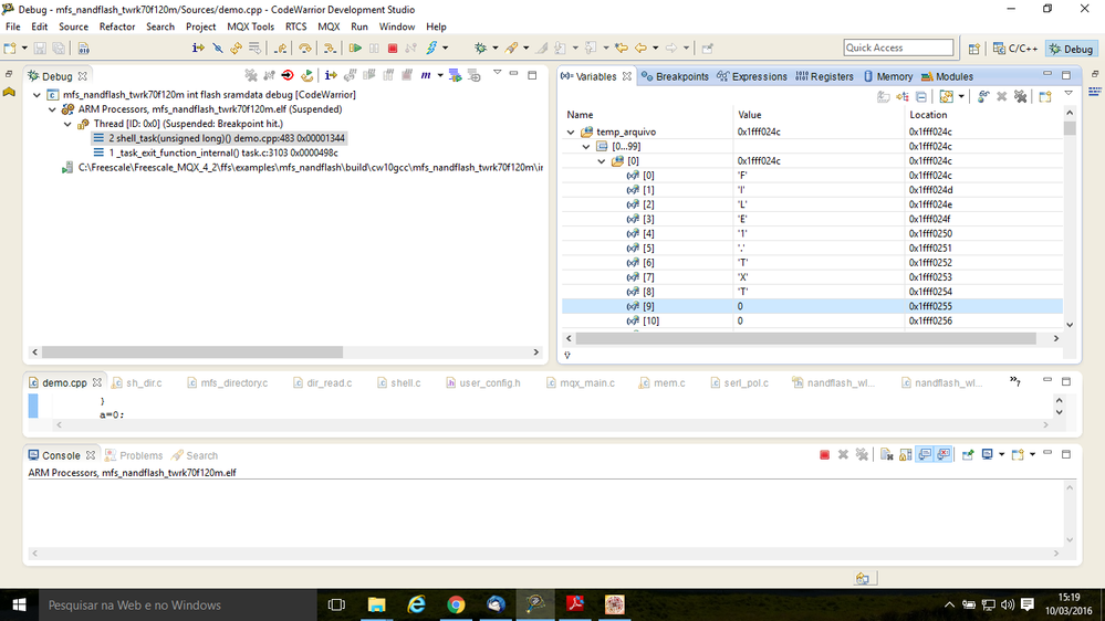

My vector receives the files names, as desired:
Now I can read the directory and I don't need to run a Shell.
