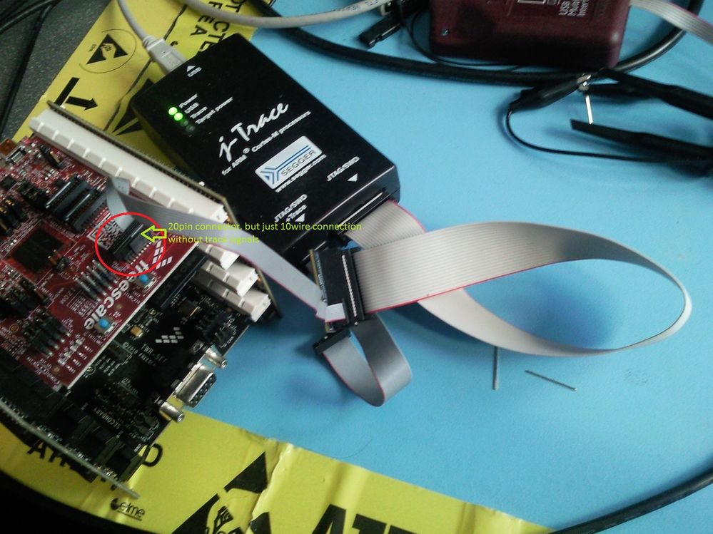

Important note:
Be aware. Some of ULPI signals are shared with JTAG trace signals!
For debugging please use onboard OSBDM interface or use just 10wire connection (without trace signals) with your external debugger!
I hope it helps you.
RadekS
