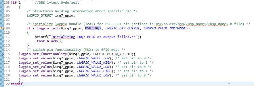

Hi Oscar,
Out of reset the IRQ7 is the default pin definintion but the EPORT has not been configured to generate an interrupt.
I'm using MQX4.0 and the M52259EVB as a test bed with the MQX4.0\mqx\examples\gpio project.
I'll attach the code but here is a picture of it:
Also I had to add a #define in the BSP m52259evb.h header as follows:
BSP_IRQ7     (GPIO_PORT_NQ | GPIO_PIN7) //DES added
I used oscope on J1 pin 39 (IRQ7) to see pin toggle..
David
