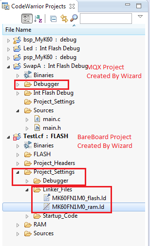

I have K60Tower : MK60FN1M0VLQ12
How to add LCF file for an MQX project?
Is it only for bareBoard project?
If I create a folder: Link Files, and copy K60FN1M0_flash.lcf into the folder. The MQX project will ignore this .lcf file. Is it the only way to edit K60FN1M0_flash.lcf in the MCU installed folder?
Also the file name to use K60FN1M0_flash.lcf or MK60FN1M0_flash.ld?

Hello David Zhou,
.ld is the linker file extension for GNU ARM compiler (well, linker), while .lcf is for the proprietary Freescale ARM compiler/linker.
In CW for MCU  (legacy) Freescale ARM compiler is available only for Coldfire devices and GNU compiler is for kinetis devices.
You can check the below document, this document contains an overview of what is the Codewarrior Linker File for Kinetis devices and how to edit it to relocate code and data. It also explains how to create a debug sesion out of external RAM.
Relocating Code and Data Using the CW GCC Linker File for Kinetis

Hi All,
I have created two project through Project Wizard: SwapA is MQX project, which doesn't include LInk Files folder, and
TestLcf is a BareBoard Project for K60, which has Linker Files folder and default .ld files. As shown below screen dump.
I need to add Linker Files folder with .ld file. If I manually create LInker File folder, copy the .ld file over, will it work?
I also noticed that the file folder structures are different for these two types of project. I needed NQX project with linker files.
If could, show me a few steps.

Hi David,
Have you downloaded the MQX4.2 RTOS?  It contains examples for the TWR-K60D100M Tower kit.
Goto: http://www.nxp.com/mqx
Click on MQX Classic.
Click Download.
The MQX4.2 has linker files for the examples included.
