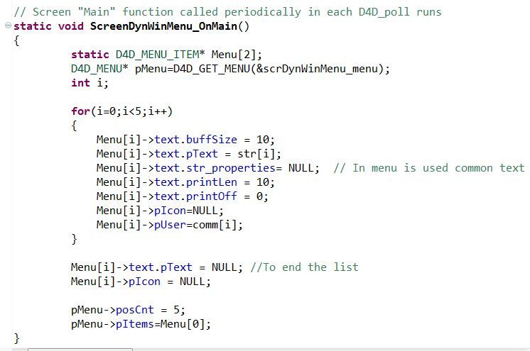

 you are close, but not in finish line :smileyhappy:
Look at this:
static void ScreenFilemanager_OnMain()
           static D4D_MENU_ITEM* Menu[10];
           D4D_MENU* pMenu=D4D_GET_MENU(&scrfilemanger_menu);
            int i;
            D4D_MENU_INDEX  j=0;
           // pMenu->posCnt=0;
            for(i=0;i<5;i++)
                //D4D_MenuSetIndex((D4D_OBJECT*)&scrfilemanger_me
nu,j);
                //strcpy(Menu[i]->text.pText,str[i]);
                Menu[i]->text.pText = str[i];
                Menu[i]->text.buffSize = 10;
                Menu[i]->text.str_properties= NULL;  // In menu is used common text properties settings
                Menu[i]->text.printLen = 10;
                Menu[i]->text.printOff = 0;
                Menu[i]->pIcon=NULL;
                Menu[i]->pUser=NULL;
               //j++
      pMenu->posCnt = 5;
      pMenu->pItems=&Menu[0];
I hope this helps, you have to keep in mind that the menu item storage that you will create has to be keep in memory (static).

 And, I will add :
static void ScreenFilemanager_OnMain(){static D4D_MENU_ITEM* Menu[10];D4D_MENU* pMenu=D4D_GET_MENU(&scrfilemanger_menu);int i;D4D_MENU_INDEX  j=0;  for(i=0;i<5;i++)  {      Menu[i]->text.pText = str[i];      Menu[i]->text.buffSize = 10;      Menu[i]->text.str_properties= NULL;  // In menu is used common text properties settings      Menu[i]->text.printLen = 10;      Menu[i]->text.printOff = 0;      Menu[i]->pIcon=NULL;      Menu[i]->pUser=NULL;  }  Menu[i]->text.pText = NULL;  Menu[i]->pIcon = NULL;  pMenu->posCnt = 5;  pMenu->pItems=&Menu[0];   }
to end D4D_MENU_ITEM list
