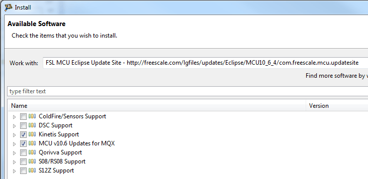

Currently I just install MQX 4.2. Before I use MQX 4.1. I already install MQX 4.2. But it doesn't appear in my codewarrior.  How I can a create new project for MQX 4.2 using my codewarrior 10.6?

Hi Muhamad,
Please do Help->Install New Software...
For Work work: click pull down to the right and select following:
FSL MCU Eclipse Update Site - http://freescale.com/lgfiles/updates/Eclipse/MCU10_6_4/com.freescale.mcu.updatesite
Then check all the modules to update you have on your system.  For mine it was following:

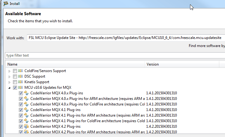

If you peek inside the MCU v10.6 Updates for MQX you will see reference to MQX4.2 that will be updated:

Restart CW10.6.4 and do File->MQX 4.2 Project
