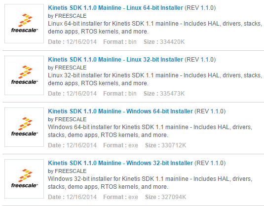

2.       Download Kinetis SDK v1.1.0 with MQX RTOS at www.freescale.com/ksdk
IMPORTANT NOTE:  As of Kinetis SDK v1.1, MQX RTOS is now available in the Kinetis SDK installer.  It is NOT a separate download.  If you want to create a MQX RTOS-based project, then use the version of MQX RTOS that comes in Kinetis SDK v1.1 (or later).
Click Download.
Choose the appropriate Kinetis SDK v1.1.0 installer for your operating system, then download and install it.

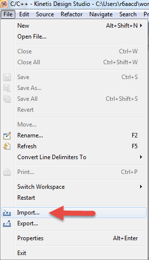

5. Import an example project working set.

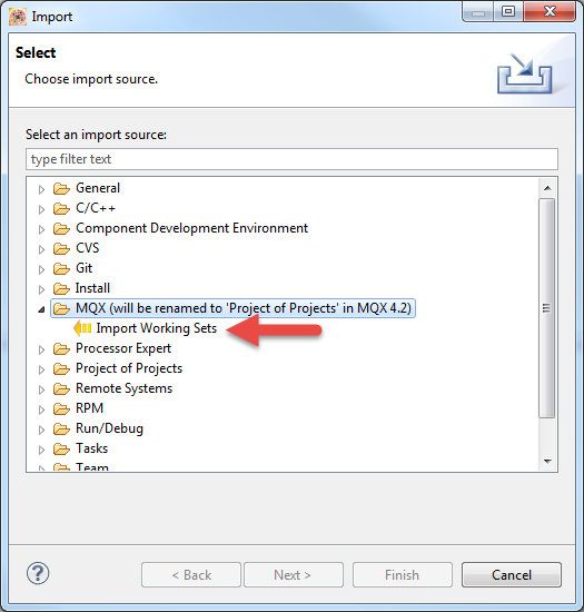

Go to File… Import, …
Then expand the MQX category (in the future this is planned to be called “Project of Projects”), then choose Import Working Sets
IMPORTANT NOTE:  Be sure to import the working set, not an individual project.  Every example comes with a working set file that has all the library projects required by the application project.  Everything you need will get conveniently imported to your workspace – so use the working sets!

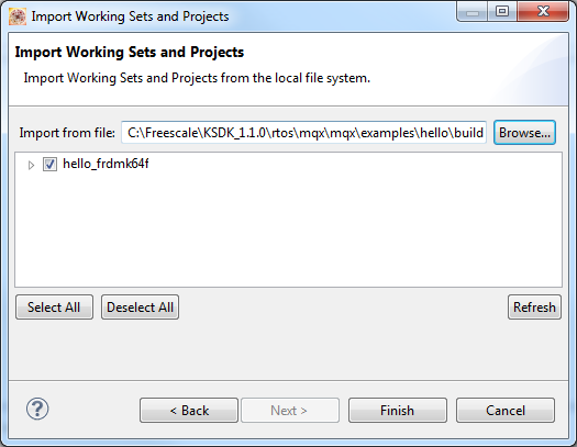

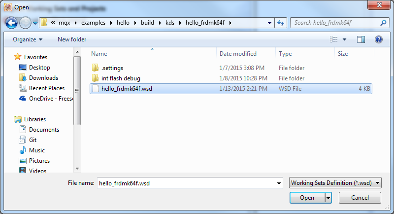

In the next window, click Browse.  Find the MQX examples in the MQX examples folder!  This is in <Kinetis SDK>\rtos\mqx\mqx
In this case I am opening the hello world example for FRDM-K64F.  The full path to the working set file is at:
C:\Freescale\KSDK_1.1.0\rtos\mqx\mqx\examples\hello\build\kds\hello_frdmk64f
Click Finish.

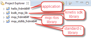

Now you will have the application project and all the library projects used by the application imported into your workspace.

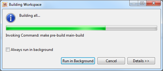

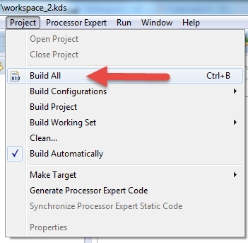

6. Now build the projects!
Go to ProjectBuild All.
Note: the default target build configuration (called “debug”) does not have all possible compiler optimizations enabled.   This makes debugging code easier, but results in larger code size.  So, if you are looking for small code size, set it up for the “Release” target config as noted in the MQX Guide for Kinetis Design Studio IDE.
The projects will now start to build.
Wait until the build is complete.

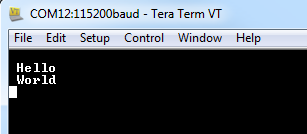

Open up the terminal program of your choice.  Select the COM port provided by the board.  For the default debug firmware (cmsis-dap) it will enumerate as mbed Serial Port (COM:xx).  Select 115200 baud rate.
You’re done!

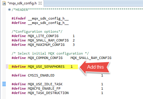

8. Be aware that several examples demonstrate non-core features of MQX RTOS that are not enabled in the MQX library by default.  To build and run these demos, you need to enable the feature to be compiled into the MQX library.
For example, if you import the semaphore example from C:\Freescale\KSDK_1.1.0\rtos\mqx\mqx\examples\sem\build\kds\sem_frdmk64f
Note: sem is the full-featured semaphore with advanced options like priority inheritance – not to be confused with lightweight semaphores lwsem
Then try to build it.  You will get this result.
Read carefully and it tells you this:
#error SEMAPHORE component is currently disabled in MQX kernel. Please set MQX_USE_SEMAPHORES to 1 in mqx_sdk_config.h and recompile kernel.
To enable semaphores, open the MQX library project and expand Config_Files.
Open mqx_sdk_config.h
Add the line:
#define  MQX_USE_SEMAPHORES   1
Now build the MQX library.
Then build your application project (sem_frdmk64f) again.
Success!
