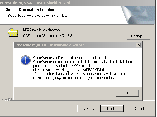

I am hoping this is an easy question and I'm just missing something simple.
I have Codewarrior 10.3 installed in the following directory:
"C:\Freescale\CW MCU v10.3"
When I attempt to install either Freescale MQX 3.8.0 (or the newer release 3.8.1), to the following directory:
"C:\Freescale\Freescale MQX 3.8"
I am prompted with following error message:
I have no previous versions of either CW OR MQX installed, and so no <MQX install dir> exists and so I can't check the suggested README.txt file.  I only have the versions listed above.
Am I missing something simple?  Thanks for your help!

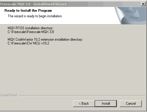

Hey Markku,
So, I figured out the solution.  So, I reverted to CW10.2 ( CodeWarrior Development Suite - Special Product Summary Page) and after that I was able to successfully install Freescale MQX 3.8.
I noticed that installation is indeed dependent on the version of Codewarrior being used, that is, Freescale 3.8 depends on CW 10.2.  Also, the CW directory that it checks is hardcoded in the wizard it appears, so that directory must exist exactly as it's spelled out since it's not configurable from the wizard (geez).
The release notes specify CW 10.1 to be the earliest supported version, but I'm guessing since CW10.3 is still in it's beta phase, the MQX 3.8 installer does not check for this.
However, on the bright side, once MQX3.8 is installed, it can be used in the latest version of CW10.3 and installing "MCU v10.3 Updates for MQX" from: http://freescale.com/lgfiles/updates/Eclipse/MCU10_3/com.freescale.mcu.updatesite
seems to add some pretty useful features.
Thanks again for your help,
Richard

soledad
Try uninstalling CW 10.3 and install CW10.2.
Then install again CW10.3 and finally install MQX 3.8.1

admin
Specialist II
Soledad,
There's no need to uninstall CW10.3.  CW10.2 just needed to be installed so that the Freescale MQX3.8 installer could find the dependencies.
Rich
