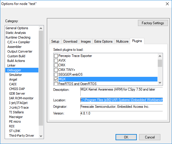

nitinhrish
Jerry
this is where you can see the current DLL usage path for MQX TAD plugin:
2,734 Views
jerrylian
I don NOT see MQX plugin in my demo options (as I delete the DLL file).
But why I can still compile and run the program? confused!
