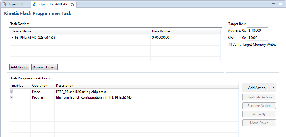

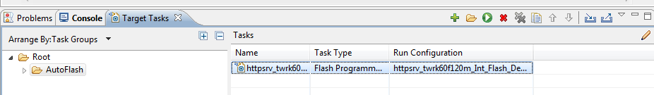

I am tring to download the httpsrv project to TWRK60F120 board using CW10.4, MQX4.0.1.
But it gives me some errrors: Error:  Couldn't download flash driver file.  Flash Driver is Not Linked To Zero.
I did it step by step just as shown below. Any suggestions or ideas will be appreciated.

Hi Daniel,
Please open the *.ttf file and change the Target RAM Address: from 0x20000000 to 0x1fff00000..
Below is picture of my script setup and I just verified that it runs on TWR-K60F120M.
David
PS
I've attached the script file too.

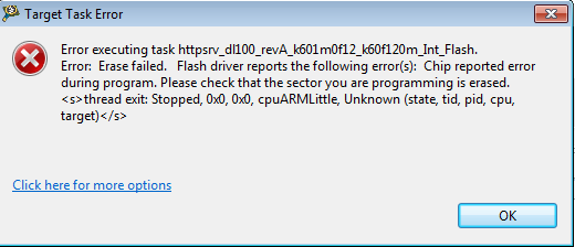

Hi David,
Thank you.
Now it can download the code but during downloading, it has other error:
Error:  Erase failed.   Flash driver reports the following error(s):  Chip reported error during program. Please check that the sector you are programming is erased.
Thank you.
