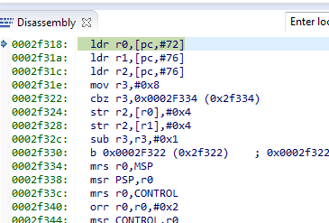

I'm attempting to get my code to debug out of external RAM on a K70 system running MQX 4.2 using CodeWarrior 10.6 built using GCC. I've attempted to follow the guide listed here Relocating Code and Data Using the CW GCC Linker File for Kinetis but still can't get things to run.
Attached are the linker .ld file, the .tcl script and .mem file I've created. I'm not en expert at working these kinds of files so there is a good chance I have something wrong here.

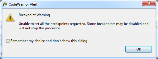

My debug configuration is setup according to the instructions linked to above. However when I start trying to debug I get a warning about not being able to set break points and then it tries to run from some place in internal flash
I probably just have something setup wrong. Does anyone have any idea what I've done wrong here?

Hi Sean,
By looking at the dissasembly image it seems like your code is not running from the ddr, please try using the attached *.tcl, *.mem and *.ld files for your project.
Let me know if it helps!

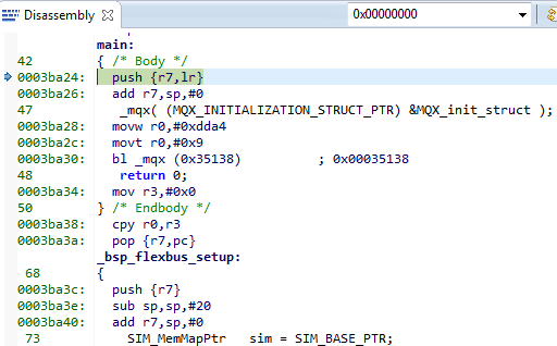

Thanks for the updated .ld, .tcl, and .mem files. I gave them a try and while the code does execute without giving me the break point warning it still appears to be executing from internal flash.
Here is the base of flash
and here is where it stops at main() in mqx_main.c when starting to debug
Both of these look like they are still executing from internal flash.
Though my variables appear to be in external DDR.
Looking at the memory section of the .ld file you attached I'm thinking things like rom need to be moved to an address that is in DDR.

That is why I changed them to the 0x70000000 range in the .ld file attached in my original post
MEMORY
    vectorrom   (RWX): ORIGIN = 0x70000000, LENGTH = 0x00000400
    cfmprotrom  (RWX): ORIGIN = 0x70000400, LENGTH = 0x00000020
    rom         (RWX): ORIGIN = 0x70000420, LENGTH = 0x000FFBE0  /* Code + Const data */
    ram         (RWX): ORIGIN = 0x70100000, LENGTH = 0x03F00000  /* SRAM - RW data */
    /* kernel space starts after RAM variables (Location of MQX Kernel data + MQX heap) */
    end_of_kd   (RW): ORIGIN = 0x77FFFFF0, LENGTH = 0x00000000
    /* Boot stack reused by MQX Kernel data */
    bstack      (RW): ORIGIN = 0x74000000, LENGTH = 0x00000200  /* Boot stack */
    end_bstack  (RW): ORIGIN = 0x74000200, LENGTH = 0x00000000  /* Boot stack end address requires 4B alignment */
That didn't work, but from what I can gather from other posts I need to somehow tell the compiler/linker I want my code to be placed in external DDR.
Do you know what I need to change in the .ld file so I can debug my code and variables from external DDR? I'm using the .tcl & .mem files you attached and am assuming those files are both good for executing from DDR.
