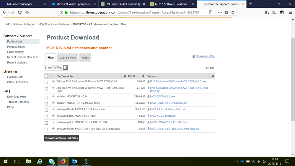

Well, from where can I download patched version 4.2.0.2?  I couldn't find it in MQX™ Classic Software Solutions|NXP. Could you please share the link?

danielchen
Hi arya vijayan
Please try this link
MQX™ Software Solutions - Releases and Patches|NXP
Have a nice day,
