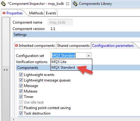

I wants to create a task (Actally I want to create total 10 tasks as per my previous project on Codewarrior). For that I followed "How To_ Create an MQX RTOS for KSDK project with PE" But that is showing me an error(without buiding project) like "Error in the inherited component settings (MQX)".
Error came when I select Configure Set : MQX Standards(As I want to use RTCS, MFS).
(Note that this erros is not coming when I select OS: MQX_Lite)
How to solve this problem?

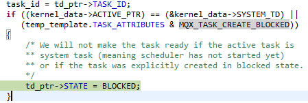

In my case, I created one task and by debugging I come to know that task is created successfully , but task is blocked from the following line...
If I have not specified the Task Attribute then how task is block? There is nothing like Task Attribute parameter in OSA_TaskCreate()..
What is floating register parameter in OSA_TaskCreate()?

It is also possible to create a task from with another task. In MQX, the task create function puts the child in the ready state queue for the task's priority. If the child is if higher priority than the creator, the child becomes the active task, because it is the highest-priority ready task. If the creator is of higher or equal priority, it remains the active task.  The child task running time depends on the scheduler.

For create task using OSA_TaskCreate(), I would suggest you refer to the following code
// Prototypes
void task_one(task_param_t param);
// Code
int main(void)
        osa_status_t result = kStatus_OSA_Error;
        hardware_init();
        //set up the basic RTOS services
        OSA_Init();
        //create task
        result = OSA_TaskCreate(task_one,
                        (uint8_t *)"task_one",
                        TASK_ONE_STACK_SIZE,
                        task_one_stack,
                        TASK_ONE_PRIO,
                        (task_param_t)0,
                        false,
                        &task_one_task_handler);
        //validate task creation
        if(result != kStatus_OSA_Success)
                PRINTF("Failed to create task one\n\r");
        //start the RTOS scheduler
        OSA_Start();
        while(1){}      //Should not reach this point
        return 0;
3,481 Views
utsavikalpesh
Contributor V
Thanks Denial,
I was writing OSA_TaskCreate() inside os_task.c file. I was creating tasks inside task.
In my project I created some tasks based on condition. On Condition occurs, the tasks will be created.
So is it compulsory to create task inside main.c file?
Say I created a task name start_task, Add_task. Now  if subtract function present (say this is checked by add_task) then  I need to create Subtract_task (using OSA_TaskCreate() ). Is it possible to create this task inside Add_task?

danielchen
Hi Utsavi Bharuchwala:
Please check the below post to remove "Error in the inherited component settings (MQX)"
How To: Create an MQX RTOS for KSDK project with Processor Expert in Kinetis Design Studio IDE
I also copied here
By the way, if you select MQX Standard in the MQX_KSDK Configuration parameters, the remaining steps will look like this.  This is because the MQX Standard configuration uses the more full featured fsl_uart component for serial communication, while the MQX Lite configuration uses the simpler DbgCs debug console component.
Select MQX Standard.
Click on the DbgCs1 component.
Disable it by un-checking the Component Enabled checkbox.
Now configure the fsl_uart component (used in place of DbgCs1).
Select the UART to use and the pins.
On the Configurations tab, select a baud rate.  Note:  You may have to tweak the clock configurations to work with your selected baud rate or vice versa (see above).
Now generate the code as in the steps above and write your tasks!
With MQX Standard, you can now access the tcp/ip stack, file system, posix io subsystem, and other advanced features included with MQX RTOS.
3,474 Views
utsavikalpesh
Contributor V
Thanks Daniel,
Thanks for guidance. I create project using MQX_Standard.
Now I am able to generate Processor Expert code for MQX_Standard without
any error.
