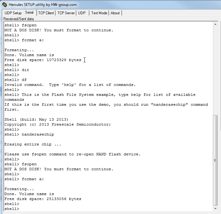

I'm using the FFS library with the example project (NAND Flash File System patch for Freescale MQX™ RTOS 4.0.0). After running the format command from the shell I always get 10 723 328 bytes free disk space.
I want to enlarge the drive to cover e.g. 100M of NANDFLASH. I tried modifiying NANDFLASH_1ST_DATA_DRIVE_SIZE_IN_BLOCK but without effect.
Has anyone got a hint for me, please? Thank you!

I opened the nandflash_wl.ffs.h header in the ffs_twrk70f120m project and changed the define as follows:
#define NANDFLASH_1ST_DATA_DRIVE_SIZE_IN_BLOCK 200 //DES was 90
Recompile the ffs, then recompile the mfs_nandflash_twrk70f120m example project and it did increase the disk space.
Note that the default 90 size gave a 10.7MB disk and a 200 size gave a 251MB size.
So the example we have is generating (or partitioning) a small disk on the NAND flash and not making it one big disk.

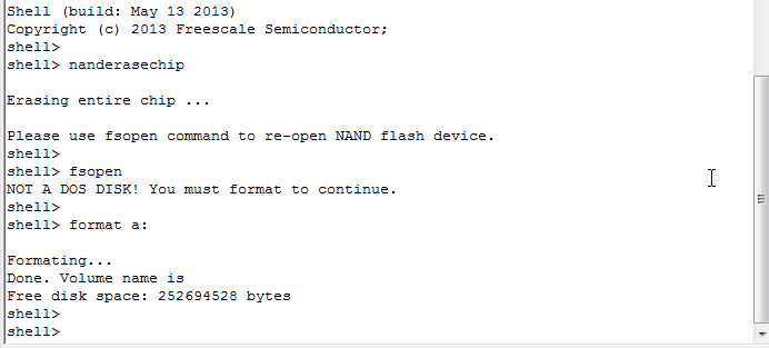

The specific NAND device information is in the bsp_twrk70f120m MT29F2G16.c file.
When I changed the block to 1937 (2048-110-1) I got a big disk.

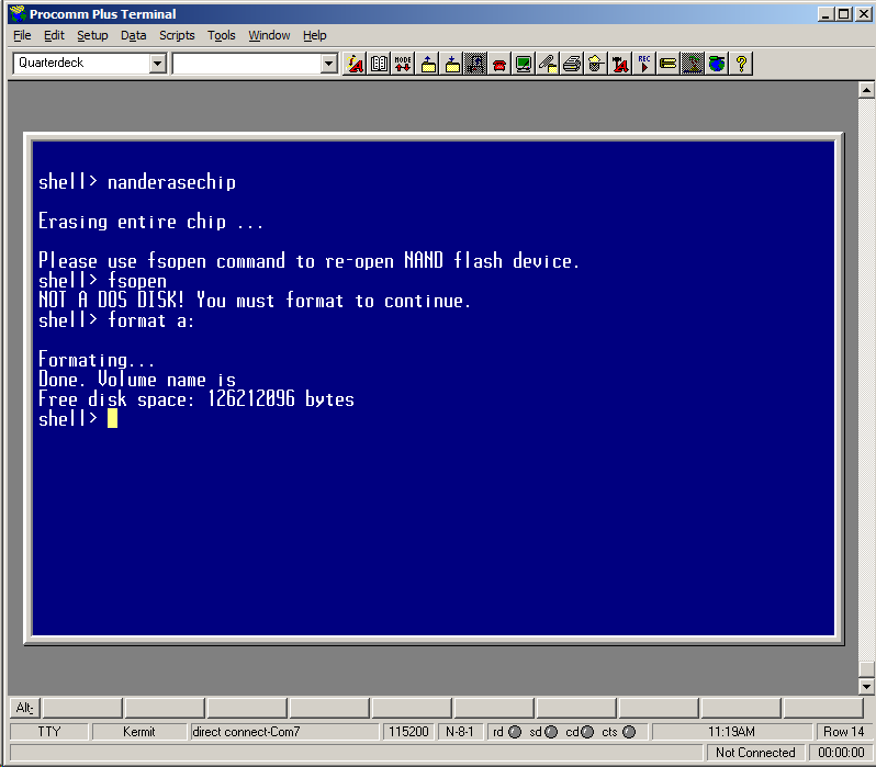

I am using TWR-K60F120, CW10.4 and MQX4.0.2. When I change the
#define NANDFLASH_1ST_DATA_DRIVE_SIZE_IN_BLOCK 90
#define NANDFLASH_1ST_DATA_DRIVE_START_BLOCK   110
to
#define NANDFLASH_1ST_DATA_DRIVE_SIZE_IN_BLOCK 1937
the disk space is 126212096 bytes. It changed but is still not the correct value.
I  tried to delete the file and replace it by a new one but it still does not show the correct free space.
Thank you.

Hi Daniel,
There is a difference.  Don’t know why but I am asking our MQX team and will respond with answer later.
Going back in time to MQX4.0.0 and the FFS applied to it and comparing the ddi_nand_data_drive_get_info.cpp files shows a difference.
If you look at the FFS 4.0.2 version it had added a “/2” to line 64 which halved the memory size for the NAND.  If I removed it to make it same as MQX FFS4.0.0 I see the correct NAND size and testing seems to work fine.

In source code of FFS I have changed
#define NANDFLASH_1ST_DATA_DRIVE_SIZE_IN_BLOCK 1937   //previous was 90
for this I am getting free disk space as 252694528
I wrote some 30 Mb data to nandflash successfully but after that I am unable to write any data or overwrite any previous file saved in nandflash, then I tried to format device but I got error as Error while formatting: 0x301d
