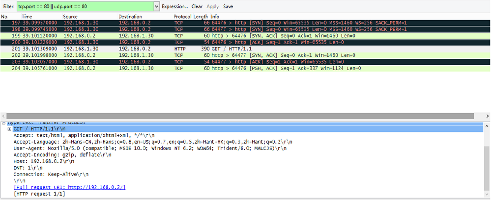

I captured data with wireshark. After client sent "GET / HTTP/1.1", MQX was supposed to send the web page. But I don't know where is it stuck.

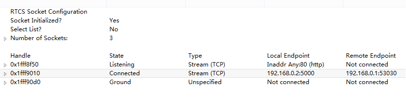

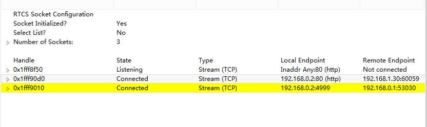

Here is my socket summary:
before trying to open web pages:
after trying to open web pages:
Is this normal? What's the function of socket 0x1fff8f50? I thought client will connect to it but it seemed connected to 0x1fff90d0.

karelm_
yes, this is completely normal. Socket 0x1FFF8F50 is listening on port 80 and accepts other connection requests from client. After accept() is called on this socket, new socket is created (0x1FFF90D0) and this socket is connected to the client. This allows HTTP server to process each request in new task while connections with clients are established in other task.
Karel
