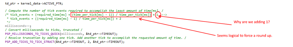

So, I started to dig into the _time_delay() function in MQX 4.2, there indeed has been some code changes since MQX 3.8; a comment found in _time_delay()is as follows:
Now it seems that by adding “time_per_tick[ms] - 1” to the “required_time[ms]” is an attempt to force the ticks to round up, which I think it will.  But I do not understand why there is the addition of the +1 tick - I believe this to be the problem.

Hi Luke:
_time_delay function translated time into number of ticks. Basically it just counts the requested number of timer interrupts. If you want to delay one tick for example, you need to count 2 ticks.
Argument of _time_delay() function is minimum number of milliseconds to suspend the task because time between last tick and call of _time_delay could vary in range 0..1 tick. I think that is the reason to add the additional tick.
_time_delay is useful when you wish to just release the CPU to other tasks for some time, it is not useful for precise delays,  for that case you need to consider different features, most likely driver by hardware timer modules.
