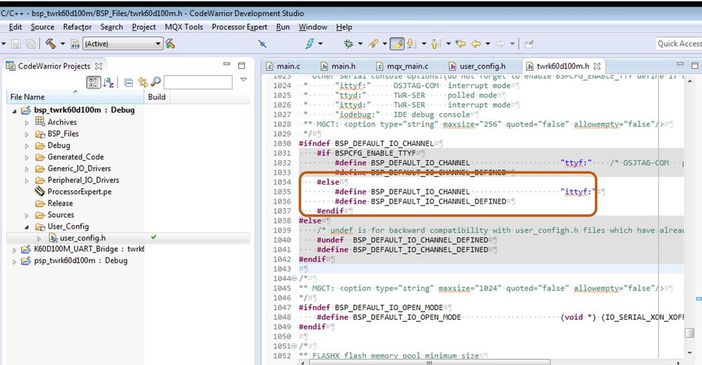

I do a small example about it (hope this can help you or serves you as guidance) using TWR-K60D100M (due this board has to UART module mapped to OSJTAG and TWR-SER’s RS232 connector).
OSJTAG ‘s USB connector uses UART5 (ttyf) and TWR-SER’s connector uses UART3 (ttyd) and first of all we need to enable this modules to uses their interrupt version.
  • Go to bsp_twrk60d100m and enter to User_Config folder. Select user_config.h. Here you need to set to 1 macros BSPCFG_ENABLE_ITTYD and BSPCFG_ENABLE_ITTYF and set to 0 BSPCFG_ENABLE_TTYD as well as BSPCFG_ENABLE_TTYF. (Prefix ‘I’ in ITTFx means interrupt driver):
  • enable UART interrupt drivers.jpgBSP libraries define TTYF as its default console channel, and due we have been disable it, we need to change ITTFY to be this default console channel. Go to bsp_twrk60d100m and then to BSP_Files folder. Here you can find twrk60d100m.h file that defines BSP_DEFAULT_IO_CHANNEL: We replace this NULL definition as shows below:
  • Then recompile MQX libraries.
After this, our UART3 (ittyd:) and UART5 (ittyf:) are configured to be used by interrupts, so every time we make a read request this task will be blocked until bytes are received.

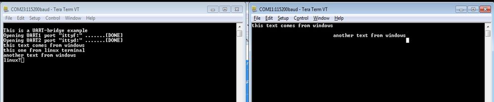

Once character has been received, it sends to the opposite UART port.
This solutions seems to response well to both terminals and will no wait until one port has received something to start polling the other port.
I attach this project (and added extra logic in case you will need to wait for a string (finished by ‘\r’ or ‘\n’ character)). I test it and seems to work as you want to.
(Note: Terminal 1 makes echo due it uses default io channel (ittfy:), but both tasks are making loopback to each other as you wanted to)
I hope this can help you.

Actually fopen function works properly, the point here is that when uart driver has been opened before, current opening configuration is not achieved. (Only first configuration is set, then, you need to use ioctl function).
In my previous code, two uart drivers are opened, the first one is the default_io_channel so it has been opened before (with default configuration) so when i tried to opened same driver for second time with IO_SERIAL_NON_BLOCKING configuration, it does not set this configuration to UART, io_open function assigns previously configured flags (settings):

So that is why I used the ioctl function to get this flags and then set the new one for IO_SERIAL_NON_BLOCKING.
This situation does not happen with second UART driver, because it is the first time that this UART is openned (if you debug your code, you will see that for second UART, flag for IO_SERIAL_NON_BLOCKING (0x10) is set after fopen function is called).
About documentation, there is no other documentation than MQX_IO_User_Guide.pdf located at <MQX_ROOT_PATH>\doc\mqx for IO drivers.
MQX's drivers are based on POSIX standard which uses fopen, fread, fwrite, fclose and ioctl functions and basically these functions should be enough to use these drivers with all their functionality, that is why documentation does not cover functions such as fstatus for example (This functions are internally created and user could make use of them if user digs further on code and understands how it is working)
Actually fgets calls fread and request to read 1 byte, then, this byte is returned. (Obviously, difference here lies fread could be used either to poll for received data (return 0 when no data is available) and also read this data (if available), that is why i decided to use fread.)
fstatus polls for received data (as you intuited) but I think it is easier to use fread instead of fstatus and fgetc combination.
Sorry for does not have documentation for these functions, but i can help you on understand how they work

It was opened to use printf and scanf functions (IO_DEFAULT_CHANNEL for MQX) and fopen is the right way to get this pointer.
If you need to use another UART port as IO_DEFAULT_CHANNEL you can define this twrk70f120m.h file.
I hope this can help you,
Isaac
