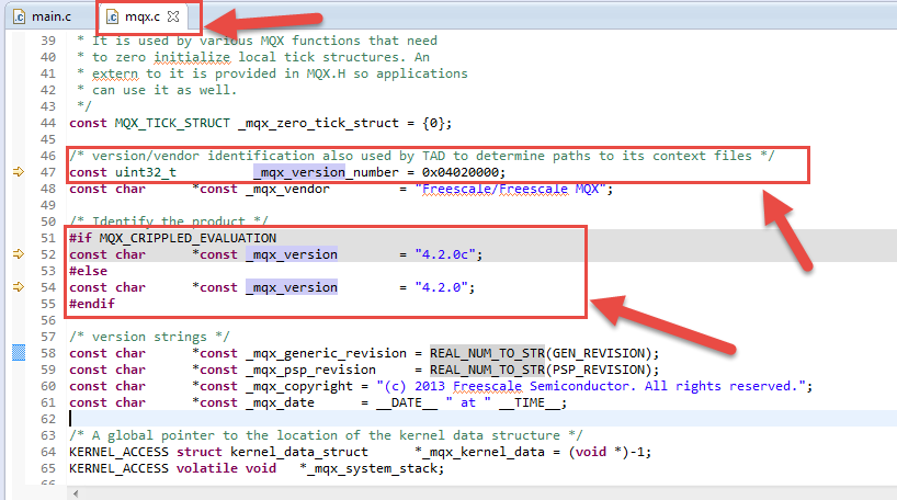

Unfortally, I only found a constant for the MQX version : _mqx_version_number
Are the the same but in macro? (i.e #define _MQX_VERSION_NUMBER 0x04020001)

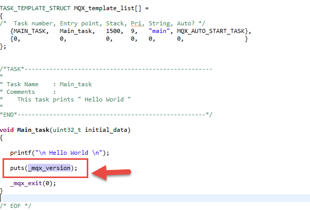

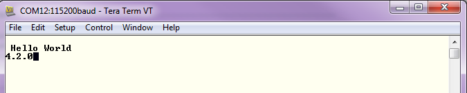

Hello Arnaud,
There is not a macro, however you can use the _mqx_version_number or the _mqx_version values.
In addition you can use the _mqx_version, this is a string that indicates the version of MQX RTOS.
I hope this helps.
