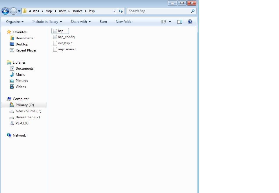

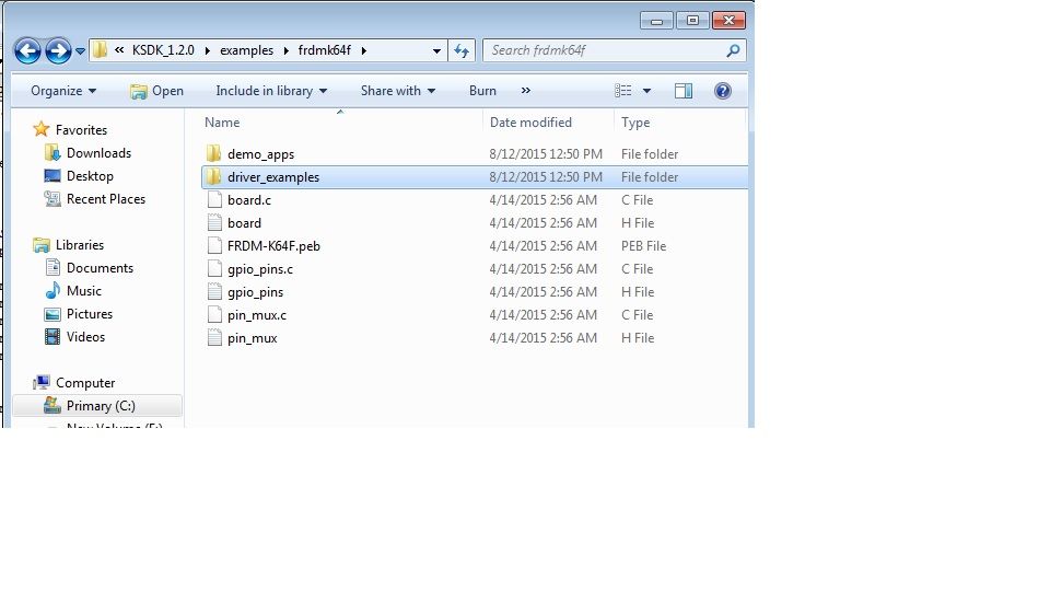

1  Overview of BSP directory in MQX classic  and MQX for KSDK
If you compare the BSP directory of MQX classic and MQX for KSDK , you will find that there are significant differences in how the Board Support Package for MQX for KSDK and classic MQX are configured.  For MQX classic directory, the compiled BSP library is used for drivers and hardware configuration (see picture 1), there are 35 files, while for MQX for KSDK directory (see picture 2), the BSP directory is nearly empty, much of the equivalent functionality of the BSP library is now moved to the example board directory. See picture 3. If you want to port your application to your custom board, these files are very important, you need to review them carefully.
Picture 1   BSP in MQX classic
Picture 2  BSP in MQX for KSDK
Picture 3   board directory in MQX for KSDK
