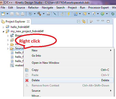

1. Import hello_frdmk64f example and just copy-paste it using Ctrl + C and Ctrl + V keys.
2. Delete the virtual folder to avoid editing the original file.

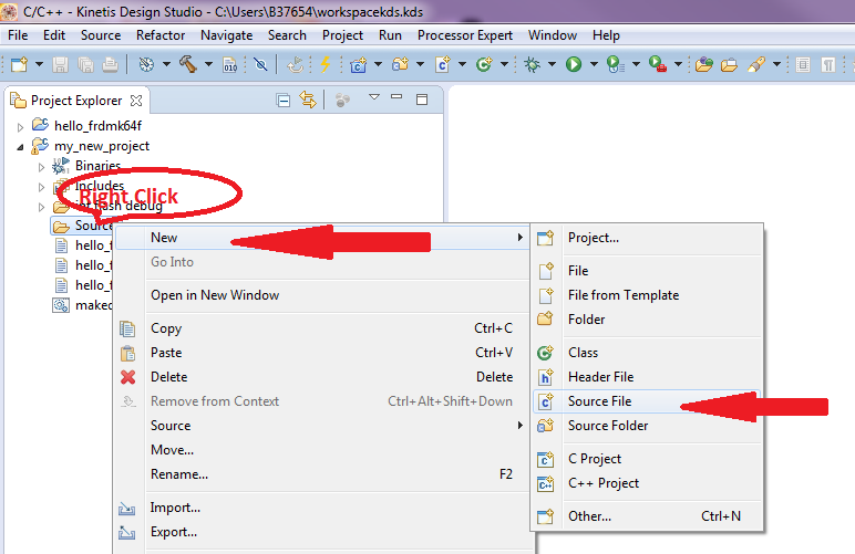

3. Create a New physical folder and named it Sources.
4. In Sources folder create a New Source file and name it main.c

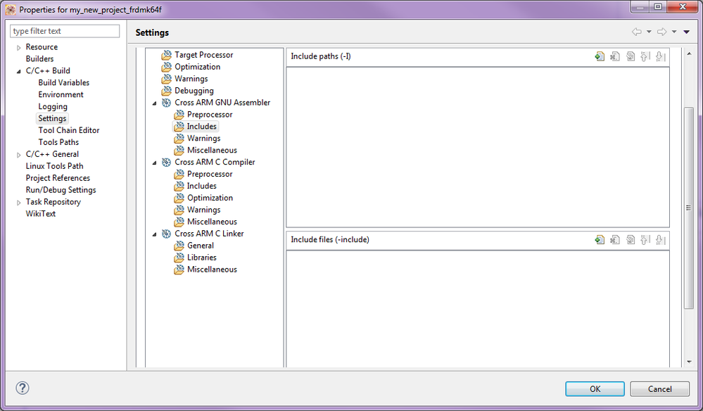

5. Go to menu Project > Properties > C/C++ Build > Settings > Cross ARM GNU Assembler > Includes and delete all the paths.

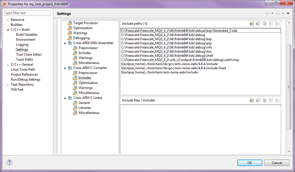

6. Go to menu Project > Properties > C/C++ Build > Settings > Cross ARM C Compiler > Includes, delete all the paths and replace them with the following:
C:\Freescale\Freescale_MQX_4_2\lib\<used_board>.kds\debug\bsp\Generated_Code
C:\Freescale\Freescale_MQX_4_2\lib\<used_board>.kds\debug\psp
C:\Freescale\Freescale_MQX_4_2\lib\<used_board>.kds\debug\mfs
C:\Freescale\Freescale_MQX_4_2\lib\<used_board>.kds\debug\rtcs
C:\Freescale\Freescale_MQX_4_2\lib\<used_board>.kds\debug\shell
C:\Freescale\Freescale_MQX_4_2\usb_v2\<used_board>.kds\debug\usbh\mqx
${eclipse_home}../toolchain/lib/gcc/arm-none-eabi/4.8.4/include
${eclipse_home}../toolchain/lib/gcc/arm-none-eabi/4.8.4/include-fixed
${eclipse_home}../toolchain/arm-none-eabi/include
For the FRDM-K64F120M
C:\Freescale\Freescale_MQX_4_2\lib\frdmk64f.kds\debug\bsp\Generated_Code
C:\Freescale\Freescale_MQX_4_2\lib\frdmk64f.kds\debug\psp
C:\Freescale\Freescale_MQX_4_2\lib\frdmk64f.kds\debug\mfs
C:\Freescale\Freescale_MQX_4_2\lib\frdmk64f.kds\debug\rtcs
C:\Freescale\Freescale_MQX_4_2\lib\frdmk64f.kds\debug\shell
C:\Freescale\Freescale_MQX_4_2\usb_v2\output\frdmk64f.kds\debug\usbh\mqx

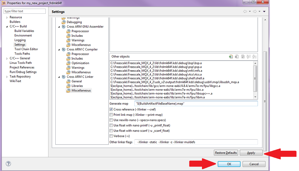

8. Go to menu Project > Properties > C/C++ Build > Settings > Cross ARM C Linker > Miscellaneous and replace all Other objects with the following:
C:\Freescale\Freescale_MQX_4_2\lib\<used_board>.kds\debug\bsp\bsp.a
C:\Freescale\Freescale_MQX_4_2\lib\<used_board>.kds\debug\psp\psp.a
C:\Freescale\Freescale_MQX_4_2\lib\<used_board>.kds\debug\mfs\mfs.a
C:\Freescale\Freescale_MQX_4_2\lib\<used_board>.kds\debug\rtcs\rtcs.a
C:\Freescale\Freescale_MQX_4_2\lib\<used_board>.kds\debug\shell\shell.a
C:\Freescale\Freescale_MQX_4_2\usb_v2\output\<used_board>.kds\debug\usbh\mqx\libusbh_mqx.a
${eclipse_home}../toolchain/lib/gcc/arm-none-eabi/4.8.4/armv7e-m/fpu/libgcc.a
${eclipse_home}../toolchain/arm-none-eabi/lib/armv7e-m/fpu/libc.a
${eclipse_home}../toolchain/arm-none-eabi/lib/armv7e-m/fpu/libsupc++.a
${eclipse_home}../toolchain/arm-none-eabi/lib/armv7e-m/fpu/libm.a
${eclipse_home}../toolchain/arm-none-eabi/lib/armv7e-m/fpu/libnosys.a

9. Click to Apply and Ok buttons.

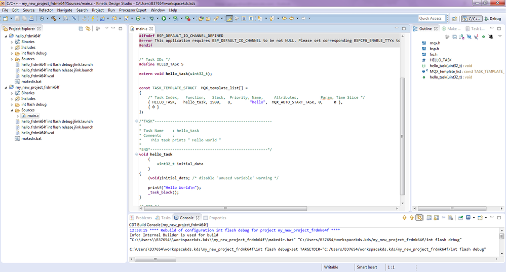

10. Go to C:\Freescale\Freescale_MQX_4_2\mqx\examples\hello and copy all the content in hello.c to main.c in your project
11. At this point you can be able to build and debug your New project. Enjoy...
