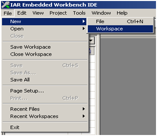

1     Create new workspace
                Open IAR  --> File  --> New  --> Workspace

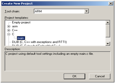

2     Create new project
  • Project --> Create New Project  --> C  -> main --> OK
  • Select project directory

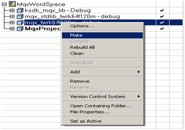

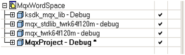

3    Add project lib to workspace
        Project  -->  Add Existing Project … then select projects:
{SDK_PATH}/lib/ksdk_mqx_lib/iar/K64F12/ksdk_mqx_lib.ewp
{SDK_PATH}/rtos/mqx/mqx/build/iar/mqx_twrk64f120m/mqx_twrk64f120m.ewp
{SDK_PATH}/rtos/mqx/mqx_stdlib/build/iar/mqx_stdlib_twrk64f120m/mqx_stdlib_twrk64f120m.ewp
4    Build All Lib project

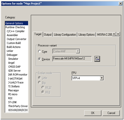

On the left workspace pane, right click on Mqx Project and select Options.
  • Setting General Options
        Select device:

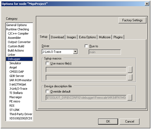

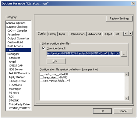

  • Setting Linker option
          Use linker file in KSDK source:
            {KSDK_PATH}/platform/devices/MK64F12/linker/iar/MK64FN1M0xxx12_flash.icf
          Set stack/heap size and define __ram_vector_table__
__stack_size__=0x400
__heap_size__=0x400
__ram_vector_table__=1
              The project request three librarys: lib_mqx.a, lib_mqx_stdlib.a, libksdk_platform_mqx.a
{KSDK_PATH}/lib/ksdk_mqx_lib/iar/K64F12/Debug/libksdk_platform_mqx.a
{KSDK_PATH}/rtos/mqx/lib/twrk64f120m.iar/debug/mqx/lib_mqx.a
{KSDK_PATH}/rtos/mqx/lib/twrk64f120m.iar/debug/mqx_stdlib/lib_mqx_stdlib.a

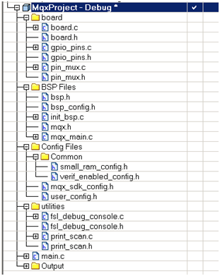

6     Create project template
Project structure and create group:
         Specific file for board in:
{KSDK_PATH}\examples\twrk64f120m\board.c
{KSDK_PATH}\examples\twrk64f120m\board.h
{KSDK_PATH}\examples\twrk64f120m\gpio_pins.c
{KSDK_PATH}\examples\twrk64f120m\gpio_pins.h
{KSDK_PATH}\examples\twrk64f120m\pin_mux.c
{KSDK_PATH}\examples\twrk64f120m\pin_mux.h
         BSP file in:
{KSDK_PATH}\rtos\mqx\mqx\source\bsp\bsp.h
{KSDK_PATH}\rtos\mqx\mqx\source\bsp\bsp_config.h
{KSDK_PATH}\rtos\mqx\mqx\source\bsp\init_bsp.c
{KSDK_PATH}\rtos\mqx\mqx\source\bsp\mqx_main.c
{KSDK_PATH}\rtos\mqx\mqx\source\include\mqx.h
         Config files in:
{KSDK_PATH}\rtos\mqx\config\common\small_ram_config.h
{KSDK_PATH}\rtos\mqx\config\common\verif_enabled_config.h
{KSDK_PATH}\rtos\mqx\config\board\twrk64f120m\user_config.h
{KSDK_PATH}\rtos\mqx\config\mcu\MK64F12\mqx_sdk_config.h
          Utilities files in:
{KSDK_PATH}\platform\utilities\src\print_scan.c
{KSDK_PATH}\platform\utilities\src\print_scan.h
{KSDK_PATH}\platform\utilities\src\fsl_debug_console.c
{KSDK_PATH}\platform\utilities\inc\fsl_debug_console.h

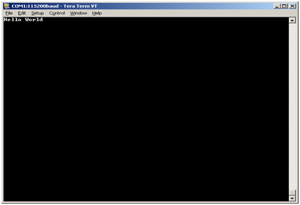

    PRINTF("Hello World\r\n");
    while(1)

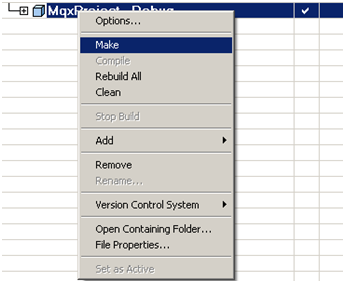

8    Run example:
  • Build project:
  • Select debug target
- Set serial console 115200 baud rate, no parity, 8 data bits, 1 stop bit, without flow control
- Set project as active prior we run project
  • Run project
  • See Led1 is On status and string “Hello World” is printed to screen
