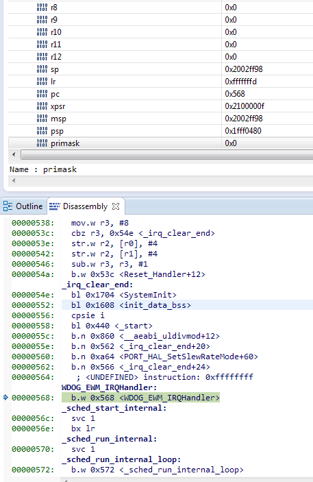

Carlos, I have followed this tutorial exactly (it is very well written), however the resulting program seems to still have an issue with the IRQ vectors.
I am using the FRDM-K64F board.
The project compiles fine without warnings, and does successfully program and begin to run, however it seems I get a hard fault / unhandled interrupt almost immediately after starting the project.  I have tried many things to determine the source of this fault, to no avail.  Nothing else can run with this project.
Here are the stack trace and registers at time of error:
All required libraries were compiled with default settings.  I have validated that it is not actually the WDOG interrupt, as the flag is not set - also if I include a handler for the WDOG_EWM_IRQ it will not fire, and one of the other undefined interrupts that goes to DefaultHandler will show in the disassembly screen instead in that case.  It seems to me this could is an issue with the vectors or memory conflict with MQX, but I do not know.
Please review this procedure as I don't think it results in a useable baseline project.
Thanks for putting this together, hopefully someone can sort out what the issue is.
Update: the interrupt was determined to be coming from a missing Systick_Handler.  I added this to main.c and the program now runs:
void SysTick_Handler(void) {}
I don't know why this interrupt is enabled or whether it is required by MQX, but a handler was needed for me to get this project working.
Good debugging Kris.Thanks for sharing fix.
Systick timer is used for RTOS TICK (heart beat) of 200 Hz or every 5ms.

Hello Kris Simonsen:
Actually your solution about adding SysTick handler is strange. Is your MQX project working as expected? Do you have more than 1 task?
The handler is compiled as part of the MQX library and it is declared in _boot.S; as David mentioned the SysTick is used as the timebase for the MQX scheduler. By defining it in your project you should see multiple definition errors and if somehow it compiled then you would be overriding MQX SysTick handler. Did you add the mqx library (lib_mqx.a) to your project?
Also please read the comments above by Myke Predko, it seems that the tutorial is missing some macro definitions for the Preprocessor. I will let Carlos know about this.
Regards!
Jorge Gonzalez
Yes, the MQX library was compiled with default settings after a clean install and is linked to the project. I followed the instructions in the tutorial. As far as I can tell MQX is working normally with the two ‘hello’ and ‘world’ tasks.
I do not get any compile or multiple definition errors with or without the handler, but if I don’t include the handler it goes to a DefaultHandler() crash the first time the SysTick interrupt fires.

Hello, Kris
I'm in the same struggle to find out how to fix this issue in MQX-SDK. I had no idea the problem could be caused by the SysTick_Handler. Thanks for the tip. When I included it in my main.c file, it worked for me too. But I don't know if this workaround really solves or just disguises the issue. I'm afraid that, during the software development, this could cause more bugs to appear. So, I feel more comfortable and secure to use the method Iva suggested in this Community: https://community.freescale.com/docs/DOC-104144.
This method clones existing projects from mqx/examples folder into the same folder so you can use it as reference for your project. It is less prone to errors.
If you or somebody else find out how to fix the issue, please let me know. I think a lot of people may be facing the same problem.
Marco Coelho
I am wondering about the exact same thing. Would also appreciate an answer!
As well, after doing so, I ran into several issues such as multiple definition errors beginning to pop up when including library headers (Re: Re: arm-none-eabi conflicting with mqx: multiple definitions of stdio.h and others causing compi...). I'm not sure if this is an ideal solution but it allowed me to add the components and compile.
Kris, I must not have read your issue clearly beforehand. I've been dealing with this issue for quite a while now, trying to figure out why my project would randomly halt. I started this community post where I tried many things (Re: Printf fails half way through printing, causing firmware to cease execution?). After adding that function I can now have my code execute properly.
However, like you I do not feel this is a safe solution in any way. It seems as though it would stop MQX from functioning properly by disabling the tick heartbeat. If MQX uses ticks internally for any timing (like task switching?) then those functions would likely break. DavidS, can you let us know if this is the case or what might be missing to not let it work? It seems this will happen to anyone who's project takes longer than 5ms to execute, making it hard to program anything useful this way.
EDIT: I just had the frightening thought. If this internal interrupt is not properly linked, then who knows what else will not be found either, and can cause other strange and subtle failures.
I thought I was onto something: Comparing the httpsrv_frdmk64f project to the project I generated here I noticed there are some notable linker settings that are different.
  • In Properties -> C/C++ Build -> Settings -> Tool Settings -> Cross ARM C Linker -> General:
    • The example project has "Do not use standard start files (-nostartfiles)" and "Do not use default libraries (-nodefaultlibs)" checked.
    • The project created with this guide does not. However, when enabling them I get this error:
      • "./Project_Settings/Startup_Code/startup_MK64F12.o: In function `_irq_clear_end': D:\Development\13214-ELMU\trunk\ETCCode\ELMU_KDS_K64\ELMU_KDS_K64\Debug/../Project_Settings/Startup_Code/startup_MK64F12.S:349: undefined reference to `_start'"
      • Therefore not finding a definition for _start in the startup_MK64F12.S file. This file is also in the example project and causes no errors, possibly meaning this setting just exposes that some needed functions are not being referenced right (like the SysTick_Handler).
  • In Properties -> C/C++ Build -> Settings -> Tool Settings -> Cross ARM C Linker -> Miscellaneous:
    • The Example project
      • Uses Cross ARM C Linker
      • "Cross reference (-Xlinker --cref)" checked.
      • Other linker Flags contains: "-Xlinker -static  -Xlinker -z -Xlinker muldefs  -Xlinker --undefined=__isr_vector "
      • Other objects includes these extra files:
        • ${eclipse_home}/../toolchain/lib/gcc/arm-none-eabi/4.8.0/m4/fp/v4-sp-d16/libgcc.a
        • ${eclipse_home}/../toolchain/arm-none-eabi/lib/m4/fp/v4-sp-d16/libc.a
        • ${eclipse_home}/../toolchain/arm-none-eabi/lib/m4/fp/v4-sp-d16/libsupc++.a
        • ${eclipse_home}/../toolchain/arm-none-eabi/lib/m4/fp/v4-sp-d16/libm.a
    • Custom Project
      • Uses Cross ARM C++ Linker
      • "Cross reference (-Xlinker --cref)" NOT checked.
      • Other linker flags contains:  "-nanolibc -z muldefs" (-z muldefs added by me to stop multiple definition errors)
      • None of the above arm-none-eabi lib files included.
Changing these settings to match does not fix the issue though. I'm going to see if I can force it to use the C linker instead of the C++ linker next.
From my point of view described issue with interrupt and SysTick looks like some side effect.
I tried follow up How To: Create a New MQX RTOS for KSDK Project in KDS guide.
Additionally I add Cross Arm C Compiler ==> Preprocessor symbols:
"CPU_MK64FN1M0VMD12=1"
"FSL_RTOS_MQX=1"""
"_AEABI_LC_CTYPE=C"
"__STRICT_ANSI__=1"
"_DEBUG=1"
and set Cross Arm C Compiler ==> Optimization as the “GNU ISO C99 (-std=gnu99)”
But I stopped at step 3.15. With this step I was able build project but without them, building cause errors (no reference to serial interface). It was strange because step 3.15 should do the same as steps 3.13 and 3.14 together.
This leads us (thank you Marian) that problem will be in compiler dependencies.
Proposed solution:
Please modify Cross Arm C++ Linker Command line patter by adding “-Wl,--start-group” and “-Wl,--end-group” commend line option.
${COMMAND} ${cross_toolchain_flags} ${FLAGS} ${OUTPUT_FLAG} ${OUTPUT_PREFIX}${OUTPUT} -Wl,--start-group ${INPUTS} -Wl,--end-group
This will resolve cyclic references between several libraries.
With these settings we don’t need step 3.15 and code works correctly on my side. I see “Hello World” on terminal.
Could you please test it on your side?
I hope it helps you.
Hello RadekS,
Short version:
I tested the changes and it did not solve the issue.
"Hello World" Always printed fine on the terminal. The issue is that "Hello World" executes too quickly for the problem to become apparent. Replace the text with longer strings and you will see that the execution stops partway through, (at the 5ms mark I would wager, when SysTick_Handler() attempts to be called.) Or add a _time_delay(10) call before one of the printf statements.
Longer version:
This helps explain one of the confusing differences between the new project and existing example projects: The existing examples only had the .a files linked, and not the libraries or library directories as described in this guide. The example projects also had -Xlinker --start-group ${INPUTS}  -Xlinker --end-group wrapping the Inputs, which appears to do the same thing as the above command. It also eliminates the need for adding the -z muldefs option as I required when adding the RTCS/MFS. Though the examples projects still had a muldefs option added as their linker options are " -Xlinker -static  -Xlinker -z -Xlinker muldefs  -Xlinker --undefined=__isr_vector" plus "Cross reference (-Xlinker --cref)" is selected. However, they don't appear necessary to compile, and are maybe just redundant.
Thank you for testing.
I spend several hours yesterday with modification of this project - but unfortunately without success.
Reason for wrong behavior is clear: Compiler/Linker somehow prefer startup code and vector table from SDK project instead of choose these components from MQX library. Bad thing is that till now we didn’t found way how to “convince” linker for implement MQX code (e.g. boot.s) instead of original SDK.
RadekS
