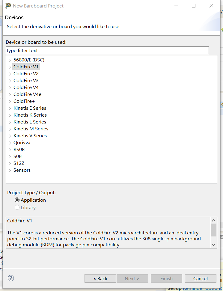

why does  code warriors10.6 have no MPC5744B/C/P/G mcu,how to program the mcu? I do not find it ?how can I find it? please help me! thank you very much !微信截图_20180530155450.png

Hi, MPC57xx are being supported by S32 Design Studio:
S32 Design Studio IDE for Power Architecture based MCUs|NXP
CodeWarrior only support MPC56xx with Eclipse IDE (and 55xx/56xx with Classic IDE)
