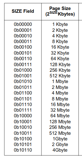

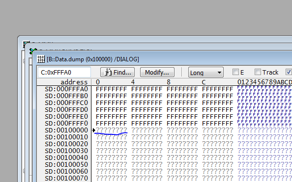

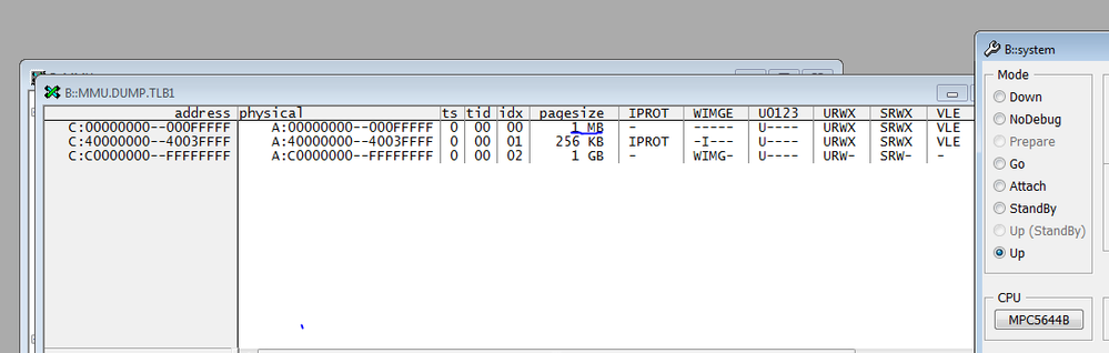

I now do the MPC5644B flash driver and need to erase the flash sectors , in the RM , the flash memory size is 1.5M, but why I can only see and access 1M.
And the memory dump :

1.5M cannot be set as number of settable values is limited. But you may set 2M, it is not problem anyhow, it should be set this way.

You have improperly configured MMU flash entry. Now it is needed to check why you have configured it so. It may be configured this way by
1) used startup code
2) used debugger scripts

Now I solve this question by set page size to 2M, but also I only need 1.5M and I don’t know if I can set it to 1.5M.
