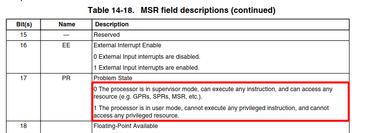

By default it is in supervisor mode. Check core register MSR.
2,536 Views
adrianonea
thank you David, I found that too but I was hoping there is more info somewhere else like what instructions/functions etc are available in each mode. However it does not matter now My software can stay in supervisor mode.do you have a MPC assembler manual?

reply from David Tosenovjan in MPC5xxx - View the full discussion https://community.nxp.com/servlet/JiveServlet/downloadImage/2-913942-186598/pastedImage_2.png  By default it is in supervisor mode. Check core register MSR.

It is following manual:
http://www.nxp.com/files-static/32bit/doc/ref_manual/EREF_RM.pdf
To simplify it -  Supervisor/User mode is given by MSR[PR]. Some registers are accessible only in supervisor mode. It also affects accesses over MMU, MPU, XBAR and PBRIDGE where different access rights may be set for target access. This is needed to check.

adrianonea
Thank you very much David,This is the info I needed.
Regards,Adrian
