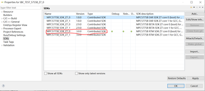

     I careated a project with SDK.  Add a component sbc_fs65, But it failed to generate code.
Component: sbc_fs651 of type sbc_fs65<br/>Description: S32 SDK Middleware for System Basis Chip FS65 family<br/><i>Repository: SDK_S32_PA_10</i>

I was able to reproduce it in RTM 3.0.0. It was obviously fixed in 3.0.3, so my recommendation is to install the latest update and use 3.0.3:

which SDK version you have? I did quick test in latest version 3.0.3. I created new project for MPC5775B, added sbc_fs65 component, it asked me to add also referenced dma and osif components. Then I added init function of SBC and I can generate the code and compile the project.

   I used the SDK version 3.0.0.
