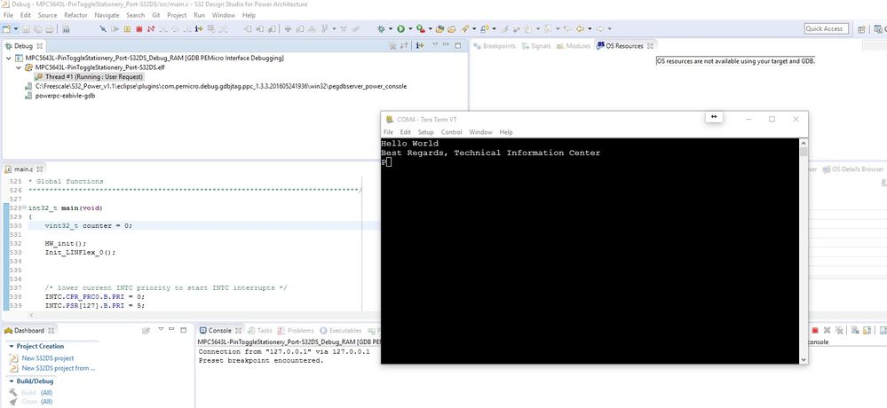

Hi , I want to use printf function in my code , so I thought we can use uart for printing printf messages. So Any one can help how to do this ?Martin Kovar
8 Replies
2,965 Views
martin_kovar
Hi.
please check example PinToggleStationery for MPC5777M.
Example MPC5777M PinToggleStationery S32DS
I wrote a document which describes, how to use printf function in S32 Design Studio. It could be useful for you.
https://community.nxp.com/docs/DOC-332018
Martin

martin_kovar
Hello Ludwig,
I did not mean you use whole MPC57xx project for MPC5643L microcontroller. But you can take your project for MPC5643L and add uart.c, uart.h and  uart_console_io.c files to your project. Then you edit uart.c file (GPIO settings and maybe bit timing) and it should work correct.
Martin

martin_kovar
Hello Ludwig,
I ported MPC5643L PinToggleStationery example for S32 Design Studio, please see attachment in this post. It is not "absolutely amazing", but it works correct ;-).
About your compiling issues, you cannot use startup from CodeWarrior, because it uses different compiler. S32DS uses GCC compiler and for example, there are no pragmas and also as I know there is key word attribute instead of declspec. But these are not only changes.
So please check the example and let me know, if it works on your side.
About MPC5748G I did not test code flashing via USB (there could be some problem with Open SDA firmware, but I guess only), but if you use Multilink it takes about 30 seconds (there is big flash memory).
If you have any other question, please feel free to write me back.
Martin
2,963 Views
nxppower912935
Hi Martin,
Kudos!!! It's working. I understand with the compiler specific parts CCW vs. GCC. Actually, I noticed compilation works if you just remove MPC5643L_HWInit.c/.h, but despite the successful download and running elf, I need to verify again what this was.
