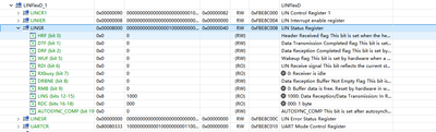

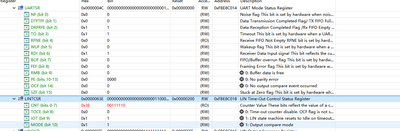

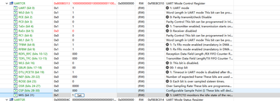

 I use mpc5748g to develop uart rx dma and timeout feature. But I encountered some problems.When I configured the program and ran it, the first rx timeout interrupt could enter and read data normally, but after that, the timeout interrupt kept triggering and I couldn't clear it. please help me!!

what is UARTPTO register setting. Does a UARTCTO reset on timeout?
You can try to set/clear SR bit on timeout as description of TO bit shows.

1、write UARTPTO for clear UARTCTO.
2、write 1 to TO bit。
