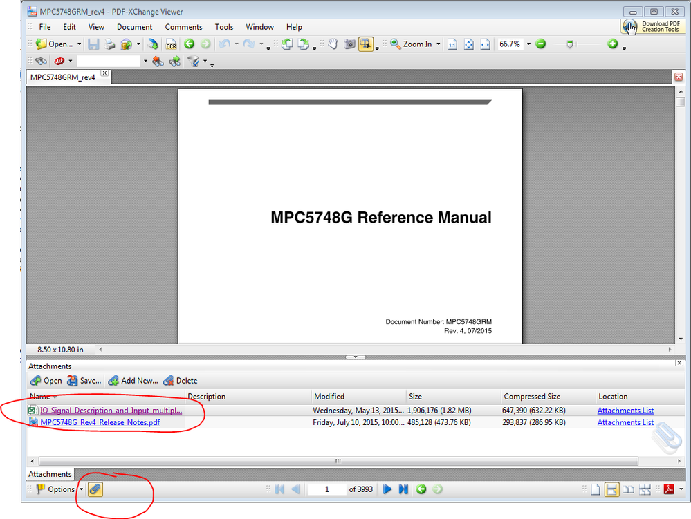

       In  the MPC5748g RM  datasheet  I can't  find pin discription,for example ,can0 pin : SIUL.IMCR[188].B.SSS=2,
How I know the bit SSS = 2.
       I used MPC5634 and MPC5643L ,in the RM  datasheet I can find pins discription on chapt 3,4.

there's excel sheet attached to the reference manual:
Lukas
