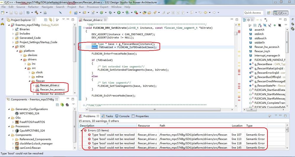

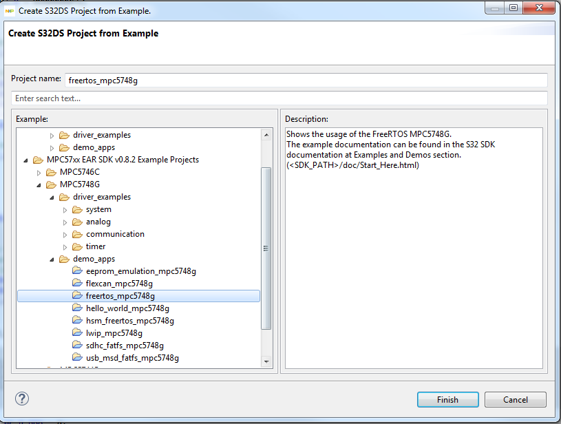

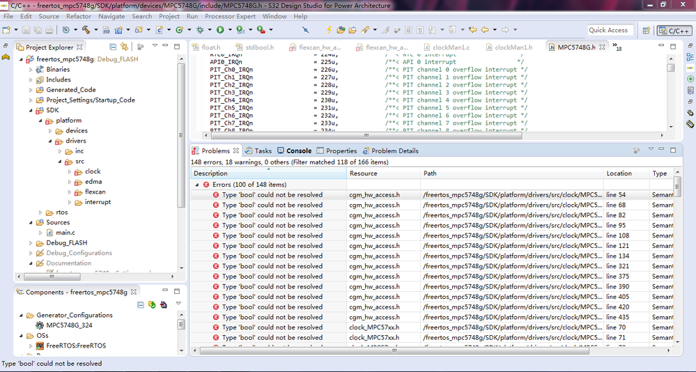

I've import a example project "frreertos_mpc5748g" , then I add a PE Component "flexcan" to the project. After generate PE code, I tried to build the project and here comes the errors ,like this :
I found that once the file contains the bool type parameters , the error happened. How to fix this issue?
Thanks a lot!

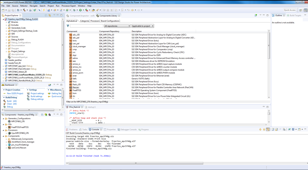

martin_kovar
I recommend you donwload newest version of S32DS 2017.R1, install update 1 S32 Design Studio for Power Architecture 2017.R1 - Update 1 available
and create FreeRTOS project from example.
Add FlexCAN component into the project. You should be able to compile project without errors.

huang_yi2006
Hi,Martin:
Thanks for your reply.
I've installed  2017.R1-Update1 ,and the problem still exist. Although there is no compile errors ,but  if I click the file covers bool type parameters like "SDK-platform-drivers-src-flexcan-flexcan_driver.c" the errors are reported.
Is it a problem about compiler configuration? And dose it impact  my project during running or debugging?
Thanks a lot
