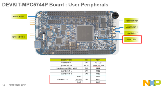

老哥,那我问一下现在我看网上最新是3.2.0,你推荐用哪款matlab,可以说一下吗? 还有就是我要烧录程序,一开始板子上的跳键帽应该是怎么样的,可以拍张图吗,会不会是我跳键帽插错了。不过用S32ds的话可以正常下载调试LED灯。

Also, I need to program the LEDs. What should the jumper caps on the board look like initially?
I do not know which EVB you are using, but there is always quick start guide or schematics available for that board. There you will find if LEDs need a routing or they are directly routed to the pins.
Could you take a picture? Maybe I've inserted the jumper caps incorrectly? However, I can download and debug the LEDs normally using the S32ds.
https://www.nxp.com/document/guide/getting-started-with-the-devkit-mpc5744p:NGS-DEVKIT-MPC5744P
