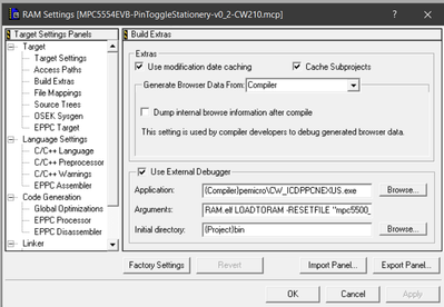

davidtosenovjan
No changes of linker file is needed, but user software should disable watchdog unless it will boot again from flash. Here you may see example for reference:
https://community.nxp.com/t5/MPC5xxx-Knowledge-Base/Example-MPC5554EVB-PinToggleStationery-CW210/ta-...

franme
hi david thank you for your help I started from a similar example, and today I have use your example, I select the ram option and i load the elf with ICDPPCNEXUS -> load a single debug file the program load all and the PC value indicate the __start point. i run the code and after some time i stop it the new value of pc is in the flash.  i don't know the problem.  can you help me thanks

davidtosenovjan
At this point you could check SIU_RSR register to investigate reset reason. Probably device is reset for some reason.

franme
hi david
I don't find the register RSR, I use your example in ram, i load it in ram the pc value is --start. but when i start the execution, the pc go to flash.
i don't use any scripts to reset o load in the ram. i disable the watchdog in the debug windows nothing else
i know the micro very little, is it necessary other configuration for run in the ram?
thank you

davidtosenovjan
If you are using PeMicro debugger, it should run debugger script at the beginning that is disabling watchdog, what I think is the root cause.
