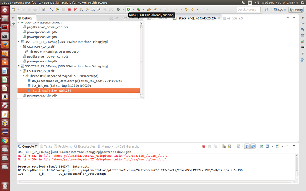

Hi All, I am getting one error is m_data is over flowed by some 50k bytes, So as per one of the post in nxp community , I increased m_data section in 57xx_flash.ld file to 50k to the existing m_data which is (128k + 50k). So I am able to compile it , but when i flashed the code on to mpc5777m board , it is not at all working  and I am able to see the error _stack_end at

martin_kovar
just a quick hint. This line in linker file seems to be incorrect. MPU_NOCACHE_BASE_ADDR = 0x4017B4E0; You started your SRAM at address 0x40000000 and length is 178KB, so address range is 0x40000000 - 0x4002C800.
From the picture you shared it seems, you got Data Storage exception and the incorrect address could be the root cause of this exception.

yalamandadosaky
Contributor V
Hi Martin, I am able to run the code on the board only after increasing SRAM size to 256k, but only two tasks are  running , we have three tasks in my code (micrium rtos tasks). So I disable one task. Can I increase to some more ( to 300k) but MPC5777M data sheet tells onchip SRAM is 404KB , I have two cores running ,one (Z4_2) I configured 128KB SRAM and   another one Z7_0 for 256KB.
To what extent I can increase SRAM size or any other option to get rid off this ?b55689

martin_kovar
unfortunately, I do not know Micrium RTOS, but you have only one possible way. If you do not have enough memory for operating system, you can decrease the SRAM size for Z4 core (if you do not need all 128K for Z4 core).
Otherwise you have to optimize your core.

yalamandadosaky
Contributor V
Thank you I got it ,Actually I am multiplying (178KB) 178*1024 in hexadecimal .
I will check the same.
