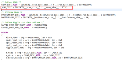

i use S32DS for Power v2.1  create a MPC5748G  core0 project,and change the linker file,because i need a custom SRAM area,so i add a new section.
but ,if write or read data in this SRAM area ,the core0 will stop.

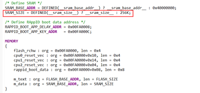

then i compare the linker file :
this is unmodified:
modify:

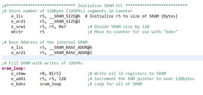

And the startup_MPC5748G.S will Initialise SRAM ECC
so, after change,this SRAM area is not initialized causing a read/write crash.

Not for this case. But you simply do branching on startup in case of SW reset, to either:
1. skip RAM init at all
2. or to exclude RAM init of the certain part which you want to preserve.
