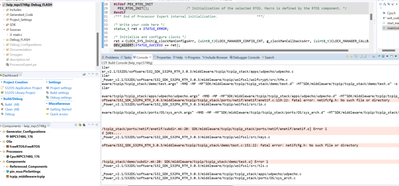

I am working on NXP Gateway board which uses MPC5748G, I need to setup Ethernet communication and checking example codes. ENET_PING : found this example code but it doesnot build. Is there any example code using ethernet interface which works using MPC5748G.

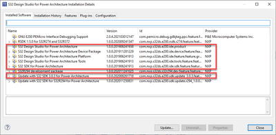

lukaszadrapa
Hi @tejo2one
If you go to:
Help -> S32DS Extensions and Updates
and
Help -> About S32 Design Studio... -> Installation Details
... could you see if all these packages are installed? That's my setup which works:
There's no way to install this as a one single package.
Lukas

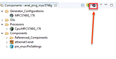

1,569 Views
lukaszadrapa
Hi @tejo2one
I can see no problem on my side. What I did:
File -> New -> S32DS Project from Example
Then I selected mentioned enet_ping example for MPC5748G.
Now the key point - it is necessary to generate the code by this:
Or select in main menu: Project -> Generate Processor Expert Code.
Then you should be able to build the project.
