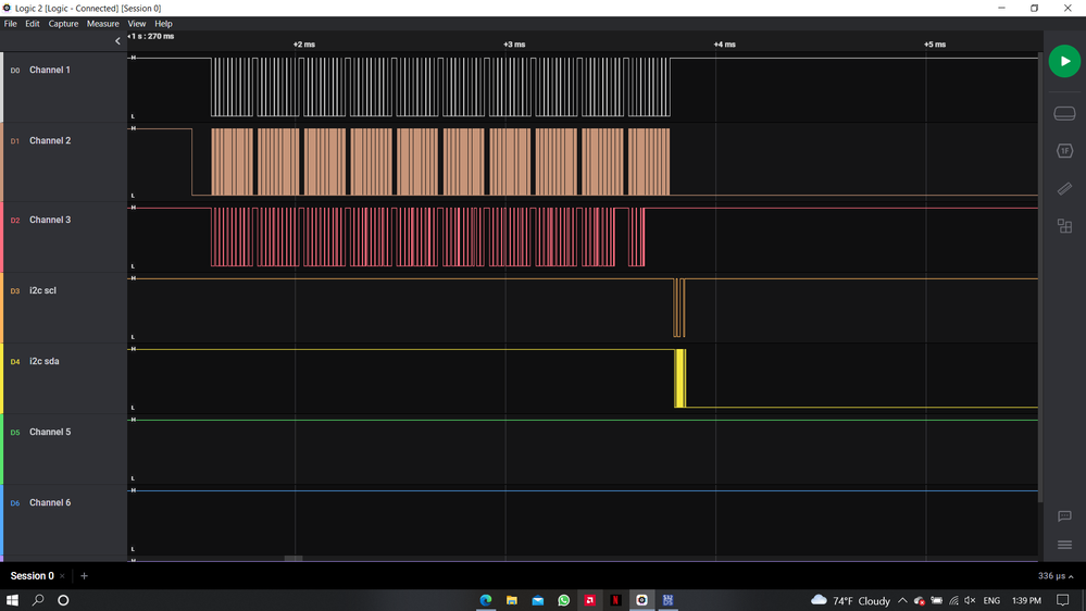

hi , i wrote the following code that sends an adrdess through i2c and some data through dspi , the data of dspi is sent successfully but for i2c its not sent all this is my code:

this is what i get on logic analyzer.
the first 3 channels are for dspi which are sent fully, the last 2 channels are for i2c which is not sent fully, i also get this dissassembly:
can you please help me by telling me how to send the second array for i2c?

do you have slave connected with slave address defined in the i2c master? So it can acknowledge first byte sent by master.
Zoom into a I2C signals and use I2C analyzer in Logic 2 tool to understand what is sent

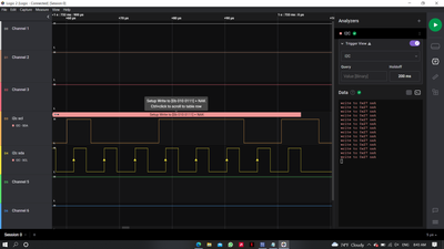

yes i do have a slave connected, where can i define the address? can you show me the way to do so?
this is what its showing:
its sending it to address 0100111 , i want to send to address 1110000

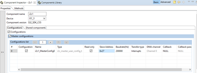

1,123 Views
PetrS
change it within master component setting
Update PE code and build again.
BR, Petr

ok i was able to change the address but it still shows me +NAK and no data is sent, how can i make it +ACK and send my data?
1,110 Views
PetrS
slave is acknowledging a received byte, so addressed slave must be connected. Here you sent slave address 0b0001000, so is it the address of connected slave?
