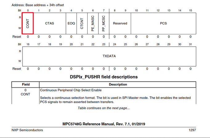

davidtosenovjan
I don't know what's the driver but in principle you can send any value for dummy bytes. Command need to keep CS asserted between data words - this can be achieved by setting CONT bit for all these words, excluding last one.

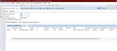

Thanks for the help. Here, the processor selected in S32DS is MPC5748G_176 and driver generated for added spi component is dspi_driver.c. I will attach the spi_driver file over here. Thanks for pointing out that CS should be selected through out transmission. But how to set the CONT bit ?

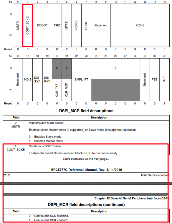

Apparently it is possible to set-up in processor expert configration:

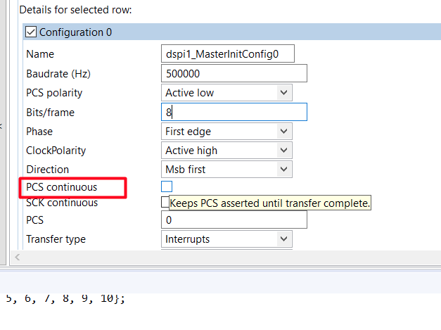

priya_p

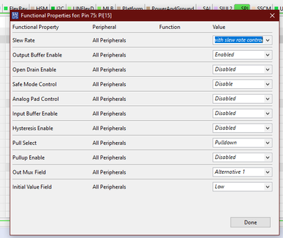

Continuous SS was already checked in the component inspector window of spi. Still it was not working. Other than calling spi_init() function, do I need to perform any other task prior to the transmission of data via spi, in case of w25n01xx NAND Flash module. For example do I need to perform any reset or disabling write protection etc..
This is the functional properties of chip select pin. Do i need to modify any properties with respect to chip select pin?  Also for MOSI & MISO pins do I need to modify any properties?

davidtosenovjan
I have checked example code dspi_master_mpc5748g and mentioned setting does affect CONT bit.
Have you measured with scope to check whether transmitted waveforms fit to communication protocol described in the datasheet of connected device? It is currently what I recommend to do to analyze root cause of the issue.

const spi_master_t spi1_MasterConfig0 =
.baudRate = 100000,
.ssPolarity = SPI_ACTIVE_LOW,
.continuousSS = true,
.frameSize = 8,
.clockPhase = READ_ON_EVEN_EDGE,
.clockPolarity = SPI_ACTIVE_LOW,
.bitOrder = SPI_TRANSFER_MSB_FIRST,
.transferType = SPI_USING_INTERRUPTS,
.rxDMAChannel = 255U,
.txDMAChannel = 255U,
.callback = NULL,
.callbackParam = NULL,
.ssPin = 0,
.extension = NULL

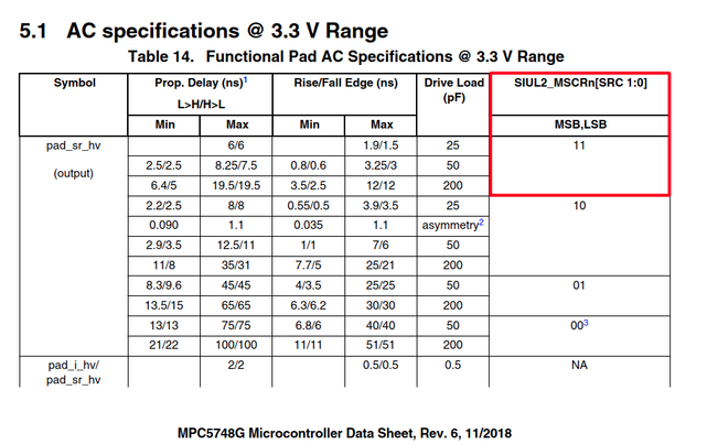

For NAND FLASH, in MOSI, CS and clk lines the fall time and rise time needs to be <5ns. But currently when measured, the rise time is 12ns and fall time is 22ns. The master is MPC5748G and the slave is NAND Flash w25n01gv. So, from the MCU software side, is there any way to reduce the fall & rise time time for these output lines of spi.
8,291 Views
davidtosenovjan
You can configure slew rate control bits for specified pads. By default 00 option (slowest edges) is choosen.

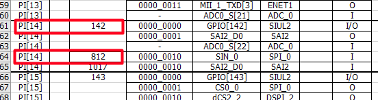

Do you have properly setup SIU configuration for input pins?
7,890 Views
priya_p
I guess MSCR and IMCR is configured in the right way. MSCR[SSS] is 00000010, so input mux[0] is assigned value 2 and input_mux_reg[0] is assigned 300input mux_1 to 7 are disabled. Also for the SPI input pin of MCU, HYSTERESYS, pull select and open drain are disabled. Do i need to modify any of these to receive data properly. If i am wrong, please do correct me.
7,883 Views
davidtosenovjan
Could you explicitly specify IMCR and MSCR numbers and their values? Thanks
7,873 Views
priya_p
SIUL_GPIO_PIN PI[14], pinPortIdx 142u, IMCR 300, MSCR[SSS]=00000010 (0X02)

davidtosenovjan
If I understand you description right (what I am not sure) I think you have it configured incorrectly. You have to have configured 2 registers MSCR142 (to enable input buffer) and IMCR300 (i.e. MSCR812 in order to route pin to module input.
7,851 Views
priya_p
Already MSCR[142] and IMCR[300] are configured and in MSCR[142] register I have enabled input buffer and IMCR[300] have sss bit and its value is 2.
