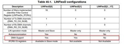

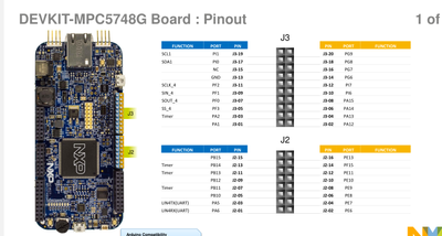

 I want to get transmitted data through DMA to UART on terminal,so I have to config DMAMUX, which DMA request source should I choose?(this is my configuration)
look,this my board,The serial port and openSDA are the same port,Is it feasible to configure LinFlexD_2 to use DMA?

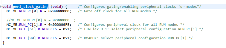

this is my  peri_clock_gating function

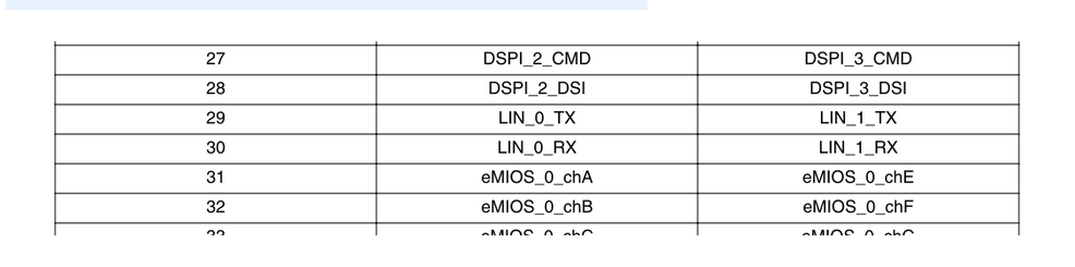

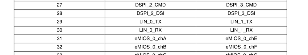

HI,
as you can see from table 71-1 you posted, source number for DMAMUX setting is 29 in case of LINFlexD TX DMA request. For LINFlexD_0 you configure DMAMUX_0, for LINFlexD_1 configure DMAMUX_1.
This device includes two DMA request MUXes that allows up to 32 DMA request signals to be mapped to the first 16 DMA channels [DMA_CH0 - DMA_CH15] for DMACHMUX_0 and the last 16 DMA channels [DMA_CH16 - DMA_CH31] for DMACHMUX_1.
BR, Petr

PetrS
only LINFlexD_0 and LINFlexD_1 support DMA

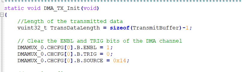

Oh!,thank you so much,I have decided to change the serial port LinFlex, If I use LinFlexD_0 or LinFlexD_1,which DMA request source should I choose?I looked at some examples, such as the MPC5775K, which use source 14, but I didn't find them in the manual

PetrS
HI,
BR, Petr

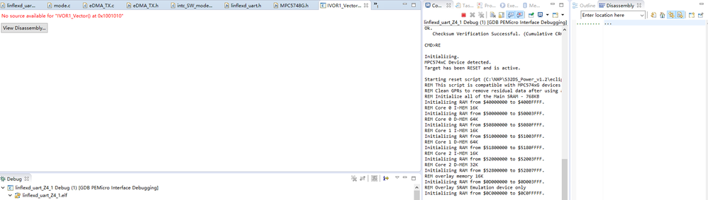

zhangk
Thanks! I have changed the serial port configuration to LinflexD_1,But now there is a new problem,Every time I go into debugging,then  click pause,It will be like this:

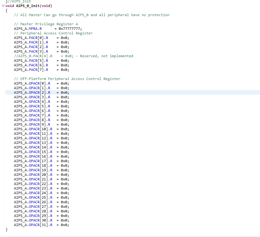

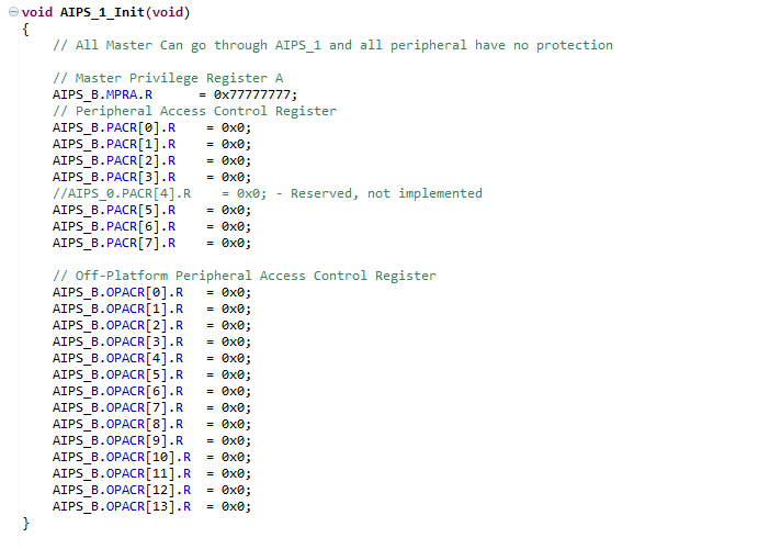

I think it's my DMA configuration that is wrong,this is my dma configuration

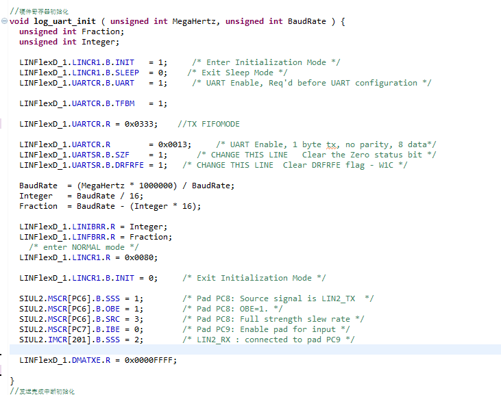

and this is AIP_INIT:
this is uart init

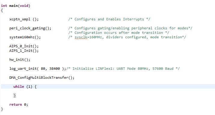

Finally, I configured peri_clock_gating
The main function is like this:
Am I missing any configuration?

PetrS
the UARTCR is not properly configured, you have several writes to register.
BR, Petr
