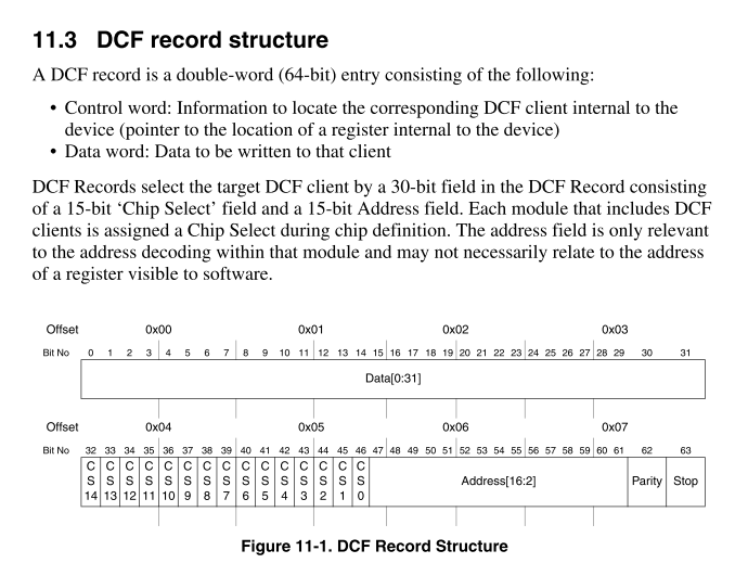

I want to access the DCF client registers in MPC5748G LCEVB.  But I didn't find any way to access these registers. How can I access these registers?
Thanks in advance

DCF records are mechanism for setting device registers during reset phase.
Detailed DCF record programming is described in reference manual : Chapter 11 Device Configuration Format (DCF) records
Please see detailed description of how should DCF record look like.
