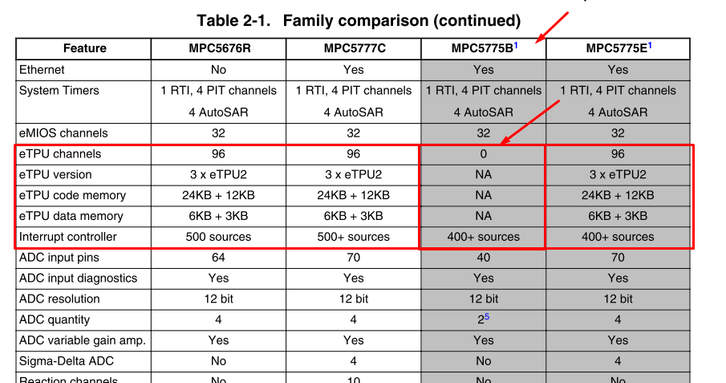

Hi everyone:
I want to use etpu module to collect pwm,
But when I reuse the pin as etpu, my pin input is close to 0V (pwm with a peak value of 400mV), which was originally a peak value of 3.36V V..
I'm not sure what happened, so I'll ask you for help. If possible, please share an eTPU capture routine suitable for mpc5775.
Best Regards
1,318 Views
petervlna
This is a bit strange as MPC5775B does not have an eTPU module.
best regards,
Peter
PS: I have check with eTPU expert an no example code is available for capture function.

1,310 Views
Fly213
Thank you very much for your reply,
I was curious why my processor expert didn't have the configuration of eTPU, so I used the program of 5775e, but why can I use the eTPU program of 5775e to output pwm at 5775b?
There may be a problem here that I can't understand, but it doesn't matter.
Thank you again for your reply, which makes me not dwell on it any more.
