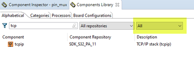

Hi @peter091
That's a good point, I didn't notice it until now. The component was obviously not ported to MPC5775B. If you select 'all' in the component inspector like this:
... you will see the tcpip component and you will be able to add it to your project. However, it will throw some errors because it's not ported. You can either try to fix it or another option is to use project for MPC5777C. These two devices are 100% compatible but you should respect the differences: 4MH flash, no external bus, no PSI5 and Zipwire, no eTPU, fewer ADC features.
You can check "Table 2-1. Family comparison" in the reference manual.
Sorry for inconvenience but currently there's no plan to fix this.

peter091
Screenshot 2024-02-14 131846.pnghello @lukaszadrapa
once again thankyou for your replay
As you said "but currently there's no plan to fix this."
but in component library for mpc5775b processor i can see enet and phy component libreary with that libreary  can i get dynamaic ip address ?

lukaszadrapa
DHCP is a feature of tcpip component (lwip). As mentioned above, easiest option is to use project for MPC5777C while respecting differences against MPC5775B.
lwip is an open source, so please follow documentation available on the web.
Lukas
