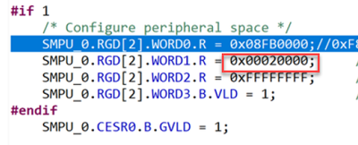

问题:程序中读取 C_PowerOffDelayTime,其放在 FLASH 区域 cali_flash,在使用 smpu 配置
后,出现 bus_error 错误,请问哪里设置有问题?
there is  an error while storing C_PowerOffDelayTime to CALI_flash with smpu configration,is the configration ok in the attachment file.

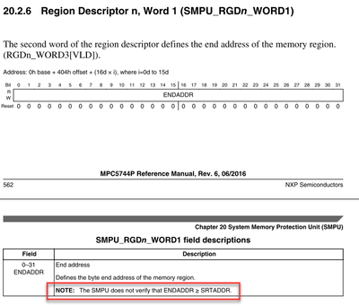

lukaszadrapa
This is not correct:
WORD1 is not size. WORD1 is end address which must be higher than start address.
Lukas
