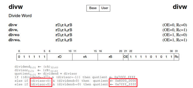

But I divide integer variable by zero on runtime. During debugging my source not stop at void IVOR0_Exception_Handler(void). Where could be problem? I wonder that. I read a post on forum like that there is not exception for e200z6. Is it same with e200z7.

Integer divide by zero does not lead in exception, it is saturated.

thanks for answer.  I have last question about this question. Dividing of integer don't cause exception. Does it same for mode 0 of integer variable such as 10%0.

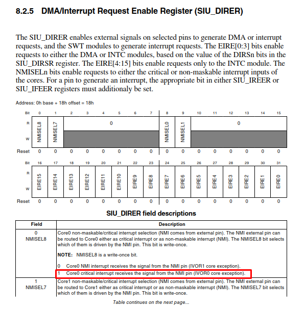

Just noting IVOR0 can only be generated with using of NMI input

There is no dedicated instruction for integer modulo.
It is done by sequence of instructions divw, mullw and subf
1) quotient = divident / divisor
2) remainder = divident - (quotient * divisor)
