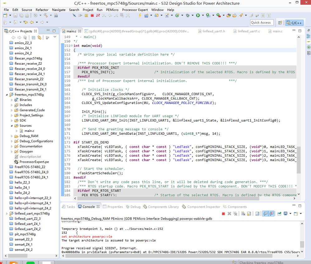

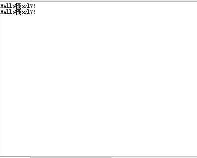

Just like this,after initializing all the components,i send a"Hello world"message to the terminal by LinFlexD[1],but it display garbled code!

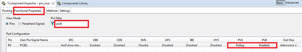

I used to face a similar problem in the past; for some reason, when routing the LINFLEXD tx signal to the pin, the logic state of the pin is not correctly driven by the module, instead it remains on a logic 0, so spurious bits may be detected by the terminal interface. A workaround for this issues was to enable the pull up function for the tx pin, so the serial communication bus remains on logic 1 when idle (detecting a 0 actually means the start bit of a character, which is the right behavior).
To enable pull up function, select PinSettings component, go to Functional properties tab, filter the pin name and select the two options as highlighted below:
Please let us know if this fixes the issue!

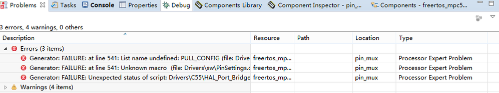

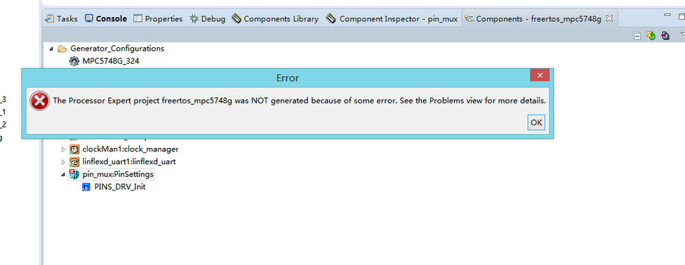

here are the errors:捕获1.PNG

Can you please confirm that you are using SDK 0.8.0? We recently released SDK 0.8.1, the update for Design Studio should be available these days; I recommend updating to the newer version, the pinsettings component was not fully functional in the first release. In the meanwhile, you could try to access directly the appropriate MSCR register in SIUL2 and set the pullup function in the code. Please let me know if this fixes the issue.
Vlad

I use this board,and i known this bug in OpenSDA interface,so i use another LinFlexD_uart which connect to the pin pc[6] and pc[7],but when i transmit data,i still run into this problem!
I found that when i choose display the data in HEX,the 57 became D7,61 became E1,62 became E2,64 became E4,and so on.
When i use the same configuration debugging project without FreeRTOS,i can achieve the correct data.
How can i solve this problem?
